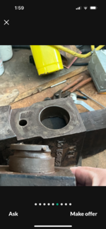

Hey, I wanted to put an update to get your opinion. It is a far drive for me to pick up, so the guy disclosed to me that, prior to driving out there, he wanted me to be aware of one area of concern on the bottom of the swivel jaw. Would you please look at these pictures and tell me what you think—would it affect performance or would it make the vise no longer worth buying or using? Thanks a lot.

Can: to me that would be a parts vise but only because it’s swivel jaw old Parker. I have more than a few great vises now but always looking to add another one if unique. When I posted on the big vise thread daily it was pretty well known that Parker vises weren’t my favorites. Mostly because the ones I found in my area were abused worse than the one you’re looking at. If you need a good old vise to use wait and find another one and maybe save up a bit to find one in better condition. Since I still actively look for vises all over the USA and mostly just in my PNW area I doubt you’d ask me about one I’m interested in so feel free to email me if you have questions. Or if you’re close to me and just need a good working vise maybe I have one to get you started while you look for the one you really want. I love Reed, rock islands and the old craftsman vises but there are brands like Parker, Prentiss, hollands, Columbian and some of the old European ones are amazing too. Good luck.

Another flaw I noticed was the non factory “horseshoe” that retains the main screw, the original part Is thick cast iron embossed with PARKER lettering. The replacement piece that some previous user installed is a lot thinner which will result in a lot of free play of the handle when opening and closing the vise.
Missing swivel base, non original jaw inserts, steel washer replacement for the original screw retainer… it’s probably still worth $60 for a user. A swivel jaw vise can come in really handy in certain circumstances. And like Drives said, they are rare.

Shift: Funny you should mention the odd looking Parker retainer that was loose in the first bunch of pics. Second bunch looks like it actually has the original Parker retainer so not sure what is up with that. I did mention hollands in my post cause they were built stout and with that look I like. That said I’m sure I missed a lot of good brands that he might find that would make him and us smile.
On my screen, the second group of 3 pics shows only the details of the cracked off sections of the rear jaw swivel. I don’t see the cast iron retainer at all in those pics. Am I missing something?

Shift: I’m not sure where the pic went of the cast iron Parker holder but I did see it in one pic. I’m with you on maybe advising Can20 to keep looking for a more functional vise cause even as cool as yours and my swivel jaw vises are they do have limited uses using that awesome feature.
