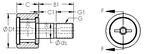

Plug in the measurements of that "stud mounted track/cam follower roller bearing" and I'll start looking for it. On yours, the stud has an additional width and diameter directly below the roller; we're going to need those measurements too.
U
Unmarked Bill
Dec 20, 2012
290
Northeast Los Angeles
Well if CWP can make that drawing at 2am I guess the least I can do is get the calipers out.
D: 19mm
C: 6mm
ID of Bearing: 6mm
C1: 3/16" this is the shoulder directly behind the roller, diam of this shoulder is 3/8"
B1: 5/8" this length includes the shoulder and the threaded area, shaft is 1/4-20 threads
