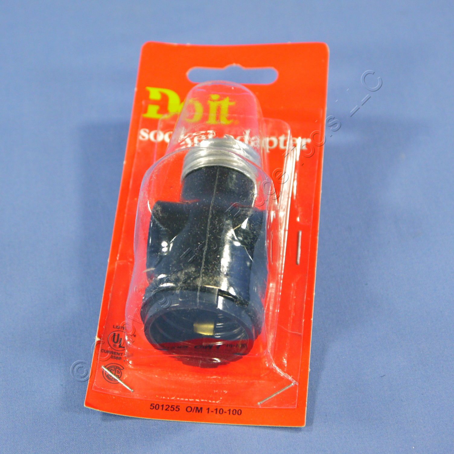

Buy two of these:
http://www.homedepot.com/p/Leviton-...t-Lamp-Holder-Adapter-R52-00128-00W/100356967
and four of these:
http://www.1000bulbs.com/product/8256/FC105-S50OD.html
You'll be amazed at how much better your lighting will be. Now it won't be great if the garage gets very cold, but otherwise you'll have ~43 lumens/sq ft which isn't bad for a cheap and really easy fix.

Tried a quick 4 dollar option, with the splitter adapter posted in a reply, so I have 2 bulbs per fixture now instead of 1. Increased the amount of light tremendously. Also, while I was on the ladder at the ceiling I noticed a block off plate about 4 feet closer to the over head from the 2 fixtures, opened it up and there is a junction block with live wires that have been capped. Im assuming thats where the plug used to be for the old garage door opener, or a single light in the middle of the garage ceiling. Im going to wire an outlet back in, and hang a left over 6 foot flourescent fixture I have at work towards the overhead. Again, thank you guys.
