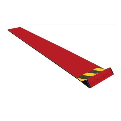

I like these:
http://www.amazon.com/dp/B004WMBXYO/?tag=atomicindus08-20
Just wish they weren't that expensive for one...

Those are cool. Actually when I logged in and saw that I thought maybe its something we should sell. Then I saw the price. When you consider you would need at least two that's almost $300.
I think http://www.garageflooringllc.com/ga...ribbed-pattern-roll-out-garage-flooring-mats/ is a better value, but obviously I have some bias in the matter :) You could even do a Clear garage floor mat
Going back to those pictures... I wonder if we can't improve on the idea. Maybe go 15" wide and 17' long and try and get a pair of them for that price?

I was just about to say can you mimic what that looks like but improve on it...
The cost is too high but the idea is excellent, and I love how it looks.
As long as it's something that can be cleaned and wider... 12" is too narrow.. the tires on my STi are wider than that... so to me it's worthless with anyone that has a performance car with meaty tires..etc.
I'd say you'd probably sell a lot if the price point was lower and it was tweaked...
-Nigel
