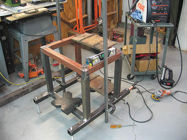

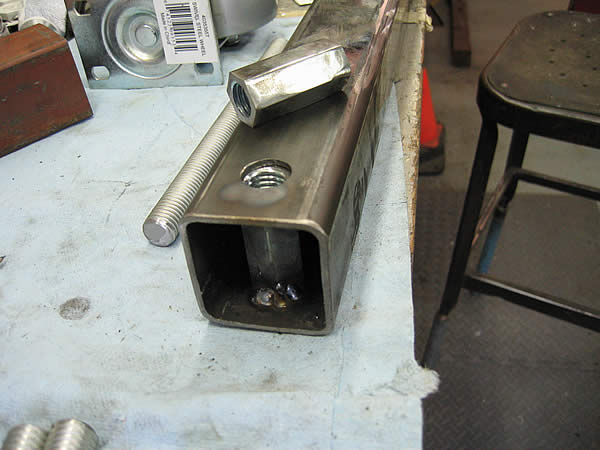

Here's what I did for my welding table. The work surface wasn't attached, but you get the idea.
The "outriggers" make it VERY stable. Despite being tall, I can lean into it and it won't budge. It does take a couple minutes with a socket to adjust the feet, but I find I'm only moving is occasionally. The plan is to enclose the bottom for scrap steel storage, add some storage for clamps and my vises, and add some receiver stock to mount various grinders and vises on it. Here's my google sketchup plan for it, prior to realizing that the feet needed to go out further to clear the wheels:
Cool setup, but shouldn't take more than a few seconds per corner with a drill or impact driver with socket adapter to adjust :) Can't believe you adjust them by hand! Though I guess if you don't move em much.
