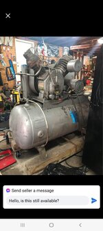

Well I can’t seem to find a 208 3phase 7.5hp or would possibly take a 5hp compressor anywhere in stock. Anyone have any leads?

$500 Yukon, OK. NOT MINE
$700 San Angelo, TX

208v motors run just fine on 240v and vice versa. In fact, most motors just say 208/240v on the windings. Not worth running a buck boost for something as simple as a motor.

Crazy as I did this earlier and now, it says 10 weeks now(208), for a 230 they do have them in stock. I was told that they would not be okay at 208V from the manufacturer (seem some motors are 208-230 and some not) and would have to get a booster which is something I rather not do since they do make 208V compressors.
I agree with buying now instead of later, Some said June 1st in a price increase.
I called some local companies not much in stock now, I found single phase but then I will need to pull power from a different service panel etc. (we do have 208 3phase and 120/240 single phase in the building/ separate meters)
Worse case I steal the big air compressor from the farm till one comes in.
I have a lead on a used compressor that might work also (till new one comes in) 200-230 3phase

Most American-Market 3-phase industrial motors are rated for 208-230/460v, but there are some 230/460 only motors (mainly cheaper ones). A lot of European and Japanese motors are also only rated for 230v/460v. I would not run a 230v-only motor on 208, it will likely run too hot, especially in an air compressor application that will see a sustained high load when being used hard (such as blasting).

Thanks, I was about to find a market place compress and get it going with a little work. So, talking to everyone I might have been about to make a 240v work and been find but might run hotter and might not live as long. I found this gem for $500 bought new belts, bolts and fitting and will give it a try till I order a new one. 47819E29-80E1-41C0-BE0D-41791CCAAE0C.jpegDA5218DA-94C6-4952-901C-216EE93F278C.jpeg
