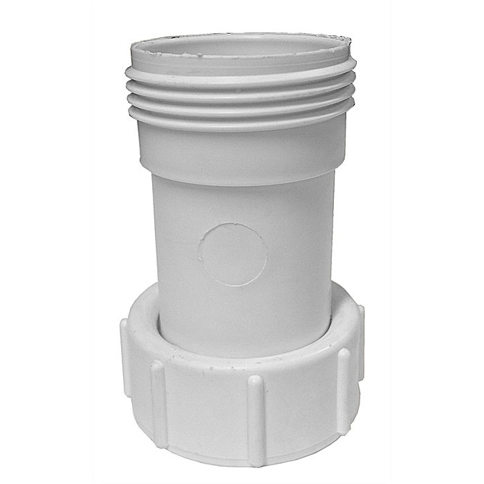

I wish it was as simple as getting an extension. However the p-trap and the pipe going to the waste like have special flanges. I have not been able to find an extension with this type of flange

jhelrey
Sep 15, 2010
7,281
MN
Yes. That extension will work. The trap has a built in washer.
You will have to buy an addional nut and slip washer
