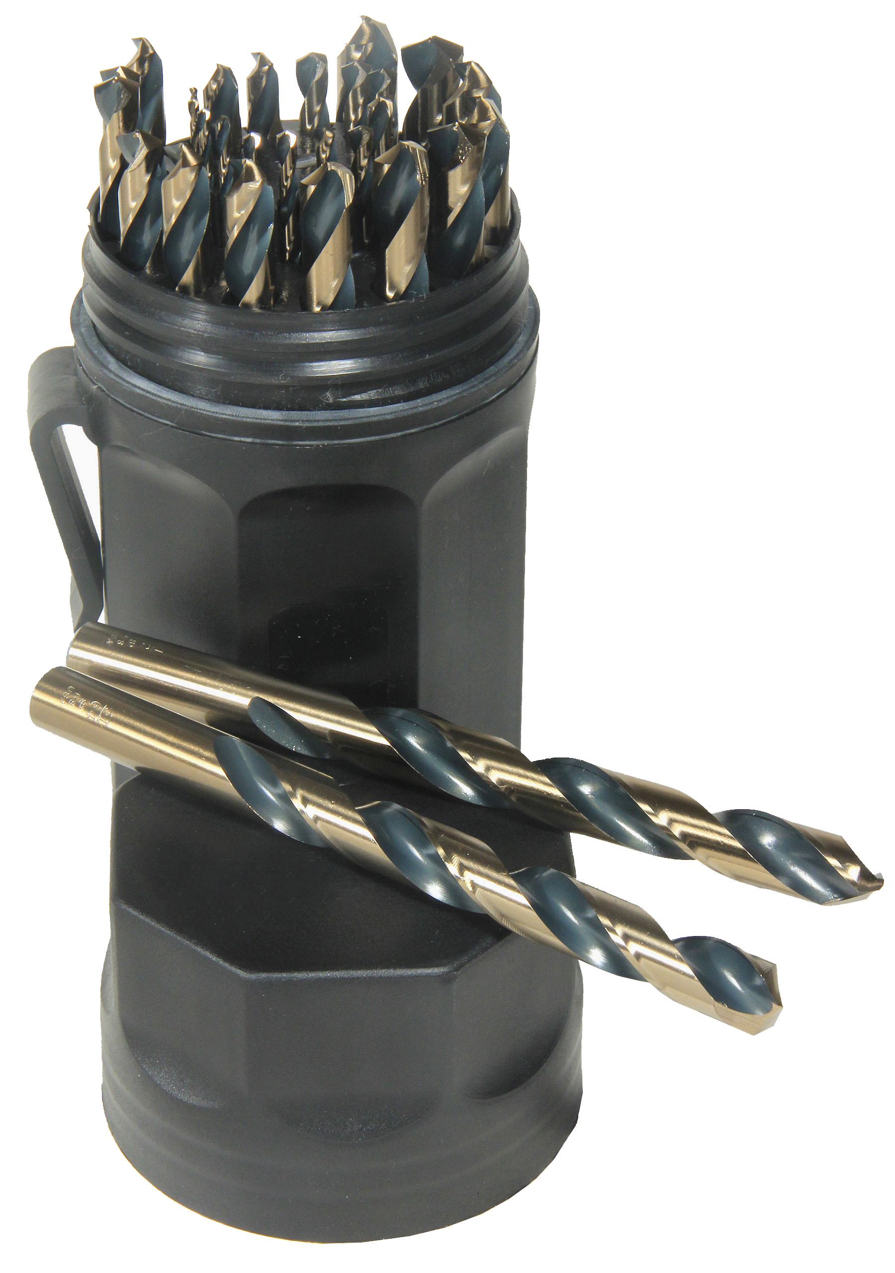

Might want to give this Norseman set a look.
So here's the official post for Epstein's Day with all the rules/promotions.
- Norseman -
We're going to offer their new cryogenic drill bit set for $99.95. This is a terrific deal as we've been selling them really well at $140.00 for the last couple months.
We're also offering their 4 pc Step Drill Bit Set for $99.95 as well. Normally sell it for $136.00.
NORSEMAN NITRIDE-CRYOGENIC TREATED 29 PC DRILL BIT SET (CT-29P)
Cryogenic treatment creates a more uniform "grain" structure by transforming retained austenite into martensite.
Modifies the carbon microstructure through precipitation of carbides increasing resistance to wear.
Nitride process diffuses nitrogen into the surface to create a case hardening resulting in superior tool lifeand exceptional corrosion resistance.
Recommended for work hardening grades of stainless steel and other hard metal drilling application.
Drill sizes: 1/16" — 1/2" by 64ths
CN-TECHTM 135 ̊Split point
https://www.harryepstein.com/index....genic-treated-29-pc-drill-bit-set-ct-29p.html

M35 or M42 Cobalt 135 degree split point drill bits are probably the best you can get. They are very pricey to buy a complete set. Individual bits go for $3.00-$5.00 for 1/2" and under, more for larger sizes.
Don't be fooled by the Titanium coating hype, it's nothing more than just that, a coating. It might offer some degree of protection, but the underlying metal is what counts the most.
Here's a set of real cobalt drill bits. https://www.amazon.com/dp/B014U8P3M2/?tag=atomicindus08-20

I have the "Super Premium" version of the Norseman cryogenic set above. Using good quality drill bits is a night and day experience over the cheapies. I still keep my Dewalt set around for the times when a broken bit is likely due to drilling circumstances.
