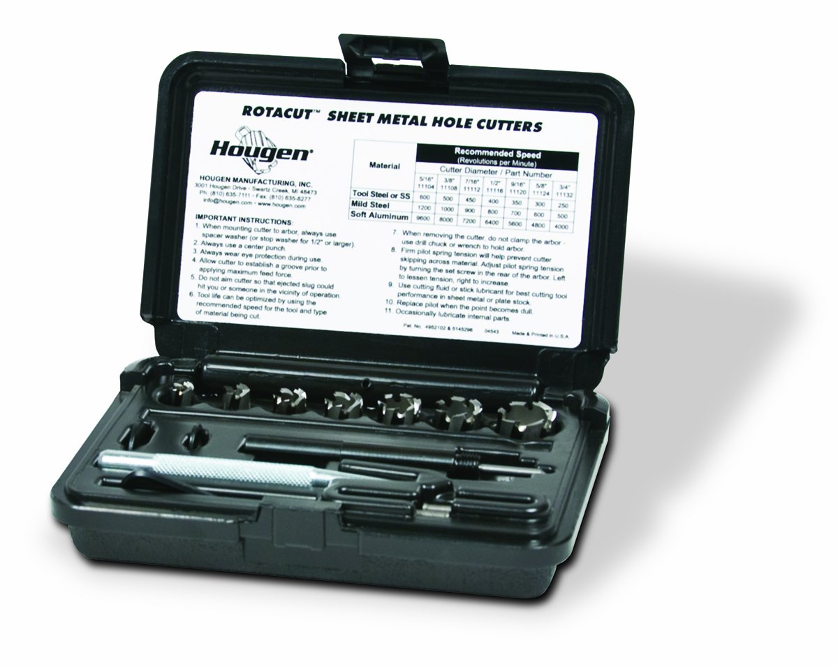

I have this set. Yesterday while drilling I had no problems drilling. Me trying to get them off was a big pain in the ****. I broke two of them. One because I was using a wrench and realized I was just putting strain where I shouldn't. The other broke because I decided to crush it with the vise. I have since been taking the other piece and putting it in the vise and using channels locks or pliers towards the top of it.
Got any better ideas???

I always grab the washer with pliers. Not the best way, but the only way other than trying to not break them.

I have a couple similar sets made by the same company. Mine are the rotabroach which I think are the same but with a Blair branding instead of Hougen. I used to have the same trouble with them.
First, if you're using the Blair/Hougen stick cutting lubricant, that stuff will clump up in the threads along with the metal shavings and make life harder. I clean up the threads on the cutters and the arbor frequently and that helps.
Also, leave the arbor chucked up to remove the cutter. I use a 3/4" open end stubby that stays near my cutters. What also helps me is to only use the larger washer, the small washer has no flats. If I'm worried about the washer hitting my work piece I have some little rubber donuts I cut to put over the piece.

When putting the cutter on the arbor I go about finger tight and if the cutter does not have a shoulder, I use the large washer and normally a 3/4 wrench will loosen them off. Otherwise pliers. I have the Blair kit, but they look to be the same.

I had to search for a picture, that is terrible the way those are setup. The real cutters (mag drill style) have a shank that has set screws that keep them in place. The ones the OP is talking about would be like having a hole saw without the keepers. I don't understand this at all, if I were you guys I would look into buying an arbor for every bit, then just leave them attached.

You must use the washer between the cutter and arbor or it'll bind every time. I normally leave the unit chucked into the drill, then twist off the cutter at the base with channel lock's.

1badbird are you the same as on yellowbullet? I actually use the washer. The first time I used the bigger washer and tried using a wrench to turn it since it had flat areas. I got it to turn with ease then thought that didn't help me do ****!

Nope, I'm not the same guy, I do have a 2000 trans am with some work done tho. By turning the washer it helped loosen the cutter for me.
