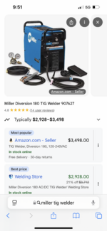

I have the Hobart version of this miller, it’s a transformer welder. When my eye sight was better I could weld aluminum cans together. Pulse isn’t necessary on the thickness you are welding. If you’re welding that material all day than pulse would be nice.

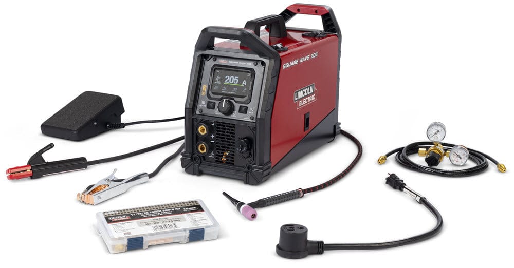

Lincoln has come out with a Square wave 205, should be an upgraded 200. It retails for $1499.
The 200 is still listed way above that.
Hobart Tig 165 is basically non-existent in New stock.
The Miller Diversion 180 is still available at a few places as remaining stock runs out. Until the end of June, Miller is offering $600 rebate on it.
The Miller replacement would be the 210 which is a full size box and the newer 212 which is the smaller "carry" size welder. Off the top of my head, the 210 is $3300-3400 with a $300 rebate until end of June. The 212 is around $2800 I think.... No rebate available.
I believe I am close on that pricing as I have been looking....dealer,web, FBMP

Lincoln gas come out with a Square wave 205, should be an upgraded 200. It retails for $1499.
Wow! I had no idea they just released that. It has a much better duty cycle than the Square Wave 200, and the $1500 price point is aggressive.
It seems to have everything OP wants, at a good pricepoint. It's got TIG pulse, AC balance control, frequency control and post flow control.
If OP can find one, that would probably be the machine I reccommend. Good job Lincoln for recognizing the changing market. No idea why the older machine costs so much though.....

I'd be very tempted to go with the Lincoln 205, that's a pretty outstanding deal at $1500.
I had the predecessor, the SW200, and I sold it not because it was a bad machine but because I replaced it with a Maxstar for what I was doing with it.
The older SW200 had a few gripes, primarily the low end. It wouldn't start an arc below I think 30 or 35 amps, which is too hot for the thin stainless I was doing lots of.
Obviously the duty cycle and the component quality is where they cut corners on these machines, they're not designed to run in a production environment. But for a hobby shop, this isn't a problem.
FWIW, you don't NEED pulse to run thinner materials. It can help with managing your heat input, but thin metals were welded for decades with simple transformer machines. Lots of intricate and incredible TIG work was done on a A/BP 330. No pulse, balance, frequency or even square wave on those bad boys. Just guys who knew what they were doing.
datasheet is pretty bare. very few specs listed. freqs? balance? pulse? amps range?
I do like the 36#, though. I don't remember what the 200 weighs, but I hate lugging it around anywhere.
50-160 Hz
60-90% balance
0.1-20 pulses per second
Post-flow controls
TIG: 10-205A
Stick DC : 15-170A
Stick AC: 15-140A
100% Duty Cycle @ 130A
60% @ 160A
25@ 205A
Quite a big improvement over the 200 IMO.
