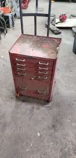

Well I agreed with you, then I found this! I scored nice on this one! This side hanger extension is the exact same one I got last week, but this one has the correct handles to match the rest of the box, all the sliders and clips are there also, but in perfect condition. I already mixed and matched it onto my box.
I found it about 1.5 miles from my house by chance, not listed as a Mac Box, but just a toolbox extension. Went over there. The guy used to be a mechanic, and set it down in his barn 30 years ago. Now he is selling the property. The bottom was rusted apart from being in the dirt, but nothing else is wrong besides a rough finish. So now the plan is, bend a new bottom for it, paint it, buy more clips, the correct handles, and put together an even bigger box with two matching hangers.
BTW, the guy was asking $50, I paid $40. I didnt even feel bad because his house was worth over $1 million. I was trying to pay $25. ;)
