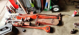

Hoping someone can help shed some more light on this. Got an M home a couple of days ago, and am trying to remove the handle. Basing the numbers off the pdf found at https://www.hcrcnow.com/uploads/drawings/heinwernermfloorjack2ton.pdf.
I got the two hex head set screws (9) out of the lower casting (only one on each side for mine, shined a light down to double check). What I am having trouble with is what I think is part 44 (chassis) "Fork Pin", going into 24 (chassis) "Handle Bushing". It seems like the small ends of 44 go into 1 (handle) "Release Rod Hanger". I did already free up 45 (Unit) "Release Gear w/GA 446 Pin". On mine, I did not see 46 (Unit) "Jam Nut", but rather used a punch from the backside of 1 (handle) "Release Rod Hanger".
What is the best way to get the "Fork Pins" out? One of them is proud just a wee bit, and the other one is pretty much flush. I tried to use a punch on the inside, but the angle formed by "Release Rod Hanger" means I am trying to drive it from a 45 deg angle.

Thanks for the bump. Right now the two options are to weld a point on the outside to grab, or drill/thread and use a slide hammer. Been on the back burner due to other things taking priority.

Finally got to this jack (been sitting in a pile for a while). After talking with Hiball via PM, decided to try and take one side off, to make it easier to get at everything. Success! One arm pin is completely out, and have easy access to the other. Now to clean everything up, paint the parts than need it, and dig into rebuilding the pump (after I clean it off).
