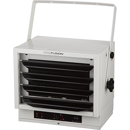

If it were mine and your electrical service has the capacity for a 240 volt 30 amp two pole breaker, I would put in something like this 5000 watt ceiling suspended heater. I have never run in to a building that I could not get wiring through it, over it, under it or around it. If your not electrical savvy, you may have to hire a pro electrician though if you choose electric heat. Good Luck. JMO
