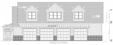

Ultimately, here is what it looks like from the outside. The main doors face south, so we decided to put awnings over the doors to keep summer sun off the doors. We're going to tie in the stone facade and the hardie plank siding. This may change some, we may go full stone front and plank on the dormers. See how much it costs.....
