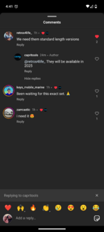

I dunno if anyone pays much attention, but Capri has been teasing releasing locking flex heads for the better part of a year now. I just got the email that they released today. 90 tooth, extra long comfort grips. They look pretty good to me so I'll probably be ordering myself a set fairly soon.

I'm very interested in locking flex head ratchets, but I'll definitely be joining the crowd over here on the Group W bench that's waiting for standard length.
As above, I really do not understand why you'd want a tool designed for restricted access situations to be that goddurn long.
