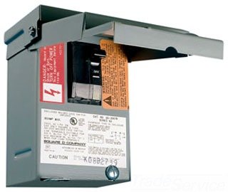

L1 & L2 should be the 2 hots coming in. A cheap solution for a disconnect is a 60A non-fused AC disconnect, it's also rated to 10HP.
http://www.homedepot.com/p/Square-D...de-Overcurrent-Protection-QO200TRCP/202353314

pattenp, thanks for the link to the disconnect. Does anyone know of any small switches, like on off, or a toggle, or something along those lines that will work for this setup? I'd like to put something small on the existing box on the compressor.

As far as a disconnect switch, u can either get an inline disconnect as pattenp suggested or wire in a single pole light switch into the starter contacts on the overload side(not the pressure switch side)....

As far as the toggle switch goes, u could even put it by the door...
