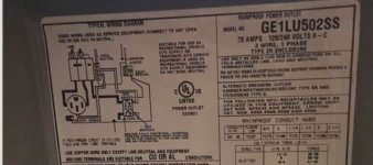

I installed the RV/service box, with the 240/110 power. I now have a question for the electricians of the group. I understand I did NOT want to bond the ground in the attached diagram, because it would provide an electrical path back to the breaker panel in the house. I have it wired as in the diagram without the bonding wire. I had 4-wire coming into the box with red/black/white and ground. The bare copper ground goes to the panel equipment ground only. The receptacle is a 14-50, with the ground not being connected. If I want to put a 14-50 plug on a welder with a 6-50, plug, do I just treat the ground lug as neutral? Hope this makes sense. I have the box wired exactly as the attached diagram, but all welding talk I see says to tread the 6-50 three-wire with red/black/ground. My ground is not used, so does neutral become ground?
Thanks,
ard
Feb 16, 2015
4,391
Sierra Foothills... California
You ground the box, and the grounds on the two receptacles together, back to the main panel.
Not sure what YOU mean by "I understand I did NOT want to bond the ground in the attached diagram, because it would provide an electrical path back to the breaker panel in the house."
You dont bond the neutral bar to box. But you need a ground. You WANT a ground path to the service.
W
wesalexleft
Apr 13, 2011
146
Memphis, TN
Thanks-I'm clear now. My mind's had eye overlooked the ground from the box to the ground lug on the 240 receptacle which connected everything.
