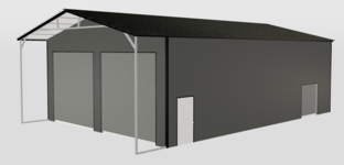

Hi all,
I am in the planning phase of my shop build out here in Central Florida and wanted to get some input on the design flow to see if y’all see any issues with it from your experience or any comment/suggestions on what you would change. This will be a DIY stick build with the exception of the concrete pour and at this point in the project, I just want to make sure I've covered the basics to avoid any regrets down the road.
Goal:
Mostly automotive hobby work will be performed, as well as other projects such as woodworking and miscellaneous house stuff. I am also trying to keep it as future-proof as possible in case I have a need for RV storage, multiple cars/boats, or just for resale purposes.
- Max size I can realistically place on my lot would be a 32x60x16 but can be adjusted
- I'm thinking of two 12'w x 14'h doors on the 32' side. (north facing the driveway, can’t place any big doors on 60 sides)
- Two post lift (not sure which bay to place it yet at the moment)
- Loft on back 32’ wall, top area for lounge/office area. Still not sure about the depth but most likely will stick to the 32' length, open to suggestions
- Tools/ workbench area / 1/2 bath underneath loft
Questions:
- As this will be a DIY build, should I make any adjustments to the size to help maximize the most “bang for the buck” I.e truss size, ceiling height, etc?
- I know people say that your shop can never be too big, but if I have all my mechanic tools under the loft in the back, is that going to be too far from the lift placed closer to the front bay doors? or should I plan on setting something up on one of the 60' walls?
- Window placement, I figured keeping them high would suffice for the purpose of natural lighting.
- Back door? It would be nice to have a back opening somewhere to help move some air when all the doors are open, not sure if it makes sense to have a door or windows I can open.
-Should I need to factor in the loft area at this point of the build? or am I okay with adding it afterward?
Here are some renderings I put together to visualize the build on the property:
Thanks in advance!

Garages are so personal that advise is hard to give. I'll offer a thought..if it were me!
I'd tuck the lift towards you loft. It'll limit, or at least be a pita to use any of the floor space beyond the lift for vehicles.
The future rv/ boat thing...no way. Just those will almost fill it. Your size is nice, so is the door size, but with only 2 doors that's your handicap.
If you were to turn it 90* so that the long dimension was the door side it would be different. But then (again my feelings) 34'-36' depth would be my minimum.
Good luck with your project. 👍

I put my windows higher on the walls for lighting and keeping prying eyes out. Same on the garage doors. You can add a loft later, adding a ledger to the wall is pretty standard. I installed my lift close to the planned location of my tool. I didn’t want to keep walking back to my box for something.
Innovate1
Jul 28, 2014
4,300
You should think about support locations for the loft. You are going to need some posts or walls for loft support somewhere and may need footings for those. A little thought about the loft now may save some work later - where the stairs might go, attachments to the outer walls and such like.
Might want a smaller door in the back for lawn equipment - no idea if you plan to keep those things there.
Put water heater, HVAC equipment and any of that sort of thing in the loft. Keeps the main floor area open. That would be one reason for building at least some of the loft now.

Based on the renderings, I suggest putting a garage door on the right side facing your backyard. Opens the space up to the yard, even nicer if adding a covered porch/lean-to on the side in the future.
rayra
Dec 1, 2014
4,724
Escaped from Los Angeles
Like that the man door is observable from the house.
Seconding the large door facing the yard, but that's a large cost.
What hurricane / tornado concerns do you have in your area and a new build would be an opportunity to incoporate some sort of severe storm shelter. What's the water table like in your area?
Yes, 'tool room' 30' from the work is not optimum. Reconsider your layout or lift position. Or consider putting your primary mechanic's tools in a rolling box that you can position right adjacent during lift work.

Thanks, everyone for the feedback so far! lots of good questions that I need to consider during the design. Based on what has been said I have done some interior rendering to help visualize the setup.
@jack stand you got a point on the RV idea, with that being said does it make sense to have two 12'w x 14'h doors or one big door with a mandoor on the side?
I did some interior renderings of what I envision based on ya'lls feedback, still need to tweak some things and figure out the best place for a large door on the side. The loft below is 15'x32':

Personally I like the one door for one bay. It defines the space for me (if only mentally). If I had a wide door I'd probably have a truck and a project of some sort, along with maybe a lawn tractor and my Gator all stuffed in it side by side.... because I can - with the wide door. Then it just might be a lack of discipline on my part.🤔
I've built 3 shops for myself, no matter the thought and planning (and budget) I've never exactly "nailed it" but never disappointed. I'm confident that you're putting enough thought into this so as not to be disappointed with the overall results.👍
Yeah originally I was thinking of having the lift closer to the door, but with it being pushed much more inside it should give me plenty of room to get things in and out with a single door (and should save a few bucks).
You are probably right, I would just hate to overlook something minor that's irreversible when completed 😅

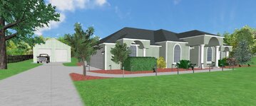

Hi all,
I am kicking this project back up and have made some changes. The new plan is to build a 30x50x14 metal building (leaning towards using Carolina Carports for this). The plan is to have two 12x12 doors out front, a single 6x6ish door on the back side and a man door. Due to the layout of my properly, I will be forced to put the 12x12 doors on the 30 wall, which is not ideal.
With that being said, I am looking for some feedback/suggestions on the best way to layout the shop. My main concerns will be where the 6x6 side door is placed on the side, and the lift placement in proximity to my tools as I will need to make these decisions first. I am open to any other suggestions you all may have!
Here are some renderings of what I have in mind, more or less the same as my original post. As of now I do have a 22ft boat (27ft total on the trailer), SxS, Harley, and a CTSV I will need to store (as of now).
This would be the approx. placement on my properly:

If its at all possible I'd try to get one of those doors up to 14'. At 14' it could be used for RV storage and even if you dont plan to ever store an RV, it would be valuable for resale.
From your older drawings you had a shed behind this new shop. If you still have that shed I'd try to put the compressor out there and run the air lines underground as part of the build.

Ah the great debate, garage doors on end wall or long wall.
With you doing a mezzanine, I think your plan is probably best. My last two shops, the door was on end and swore I wouldn’t do that again. Biggest issue was only having a single door so if you had a vehicle there, you couldn’t get bulky items in or out.
After watching a video recently with a shop built just as you planned and our house plans changing, I wouldn’t mind the double doors on the end because of the size of the mezzanine you can have. Current in town shop has a 20x24 and 8x24 mezzanine.
Unfortunately we don’t have a crystal ball, or the cash to have multiple shops. 😜

Neat layout program, I went 34' wide, two 12x12 doors and have a good amount of room between rv and trucks. Try not to get in a hurry before sheetrock.
