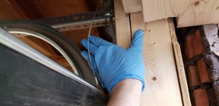

Alright so I ended up cutting out some brick, and putting in a new garage door next to an existing door.
Has all new hardware and everything. Doors level, theres ample gap between the rollers...the sections are straight.
Single overhead torsion bar spring setup with rollers and cables at each end.
Im completely at a loss here because while inside, the garage door when at the bottom of the travel the cables are tight. At the top of its travel, the left side cable gets extremely loose while the right side remains super tight.
This is causing binding against the bottom roller on the right side and hardware between the radius section so badly I cant get the door to close with a side mount opener. It binds but can be forced shut manually.
I tried untensioning the spring and putting a preload on the left side before tightening the set screws for the left side roller. The door actually was level before doing this. Now the door is actually slightly crooked with the left side being slightly picked up more than the right side with the door all the way down.
But the same thing happens!
I tried for 4 hours to get this to work properly and I'm fed up
Does anyone have any idea what I may be doing wrong?

Pictures attached

Are the horizontal tracks square to the opening?
They appeared to be, maybe theres a better way to check other than by eye or tape measure on the ground
I even measured the distance from the floor to the bottom of the roller brackets and it's the same.

Is there a difference in the circumference of the drums by chance? Is the tight side wrapping over its self where the loose side isn't maybe. If it is rewrap it maybe. Sorry being on a phone doesn't let me zoom in enough.

I can't tell for sure, but it looks like the cable drum on the motor side is higher than the one on the opposite side. Measure from the top door panel reinforcing rib up to the torsion shaft center line on both sides of the door - they need to be the same.
You can check the horizontal tracks squareness to the door by measuring diagonally from the ceiling supported end of the track to the track support wall attachment point on the opposite track. Both measurements should be the same.

The torsion bar seems to be sagging in the middle. Usually there's a support in the center of the span. Also the door doesn't seem to be level with the header (right side is low). Maybe it's just the way it looks in the picture.

The cables have to be the exact same length and the drums have to be set on the shaft in the same orientation to each other. This will pull the door evenly on each side.

Lift the door by hand and see if the ceiling end of the track is binding on the door. If it's catching on one side that would let the cable loosen up on that side.

Appreciate the feedback. Ended up fixing it today with fresh ideas and fresh eyes.
I measured the ceiling track width it was not the same as the wall tracks. It was before I made adjustments but I started with correcting the track width.
It was 111" iirc
Then after that I measured from the top flag bracket to the end of the ceiling tracks it was way off.
Once I made the measurements equal by moving the tracks over a few holes, I remeasured just to make sure my track width was the same.
After that the door is working good
I then untensioned the spring, made the cable drum on the left side match the cable drum on the right (no preload), retensioned the spring and it's perfect
Thanks again, sometimes it's the stupid small stuff that can get you

Your rear hangers are not square to the front wall. You have a parallelogram. You need a rectangle. Measure cross corner at the track. Left side at flange where it meets the wall, rights side at the rear of the track. Then measure the other way. They must be the same. If not then re locate rear hangers to make them square.
