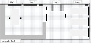

Getting ready to build a house, shop & a barn on our property a bit east of Seattle.
The house will be in the modern "mountain lodge" style. Large single story, lots of glass. It will have an attached four car garage.
The shop is planned to be around 2400 square feet, somewhere around 60 X 40. I plan on having the usual shop tools; blast cabinet, welding equip, several tool cabinets and work benches. Plus tire/wheel racks, parts storage, etc. Will also have my four pinball machines and two kegerators.
One two-post lift and two four-post lifts.
The dimensions and size are quite flexible, as is the design and layout. I've been having difficulty figuring out this project, to maximize efficiency and convenience. One possibility is to have a mezzanine loft area for the pinballs, kegerators and "office" area.
I've been in shops that have the doors on the narrow side, and ones with them on the wide side. One thought is to have a center aisle with cars parked on both outer sides. Or, a separate tool & parts room...
Seeking experienced opinions on this. Would much rather get the design right than try to fix it later...

I debated with this a bit before building my garage. The center aisle is inefficient because it's a lot of space that you need to keep clear if you want to move vehicles in and out. I ended up building a 32x80 with ~500sqft loft. My needs were:
  • workspace to work on cars with 2 post lift, welding equipment, benches, tool storage
  • separate room that I will use for a wood shop (could be your man cave)
  • storage for many wheels, tires, car parts
  • parking for several cars
See the attached picture of the layout that I came up with. It worked well with my property. Bays 1 and 2 are my shop space and are full height. The perimeter is lined with some shelving, a bunch of workbench space, and all my tools. Bay 3 has the loft above it for storage with a room below that I'll use for a small wood shop (currently a paint room). Under the stairs is my utility room (compressor, electrical panels) and wood storage. Bay 4 is parking (also full height). I'd like to get two 4-post lifts in here and think I can, though it would be easier if it was 36' wide. I was restricted to 3000 sqft by the county, so I decided to keep the length and sacrifice width. There is a full-height wall separating bays 1 and 2 from 3 and 4 so that I can heat and cool them separately.
I'm happy with the layout, but if the county let me have my way I was going to build a 50x80 with two 25x80 sections. The first section would basically be a 7ft-narrower version of my current garage (except for loft over bays 3 AND 4). There would be a full-height wall separating the other 25x80 which would have doors on the 25' sides so I could pull a truck and trailer in there. I could line the center wall with pallet rack and have more storage than I could imagine. It wasn't going to be that much more expensive, either. Hopefully you can get some ideas from this.
