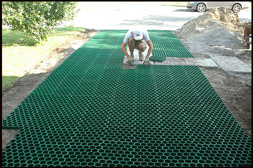

I strongly disagree with "the limestone guy".
You need just as good a base under a gravel drive as you do under concrete... unless you want it to settle and get very uneven.
We dug ours out with a tractor and box blade. I had lots of sandy loam. I removed it all down to rock and clay. Brought in about 12 yards of crappy fill soil that compacted very well. We got our fabric from US fabric. Fortunately they had a distributor 90 miles up the interstate from us. Got all I needed, with a little left over for under 600 delivered. The stuff is amazing, and adds tremendous stability.
Pics attached.
Four years later it still looks great and we just used recycled concrete. Spread it with the same box blade at a different rake (tilted up in front).
