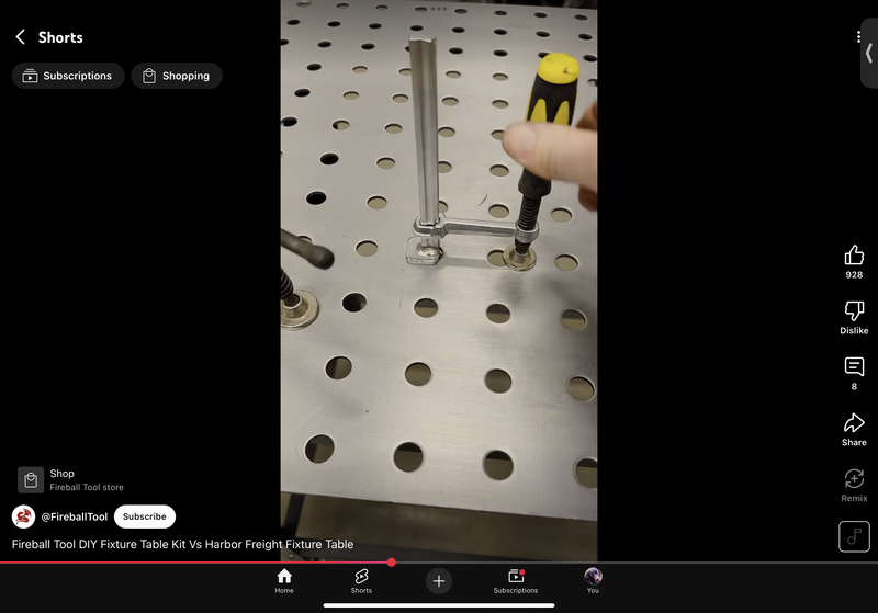

Haven't they come out with a style of clamp for these thinner tables that hook through from the top, rather than requiring a nut on the bottom? I just tried to search for them as I swear I have seen them but I came up empty.
Fireball tools has a video comparing this table to their five hundred dollar table. I was surprised that he said the HF table was a heck of a deal.
He demonstrated that the hook-on clamp shown below works a lot better on the HF table than the screw on ones it comes with.
I just bought my table on sale today for $149 and just ordered a 4 piece set of these hook on clamps. I also order M10x1.5 locking wheels.

Image from fireball video showing the clamp.

Fireball tools has a video comparing this table to their five hundred dollar table. I was surprised that he said the HF table was a good price for a hobbyist level table.
Here is a link:
Exactly what I was talking about. One of the biggest advantages of the hole style tables is speed, which you lose if you have to screw the clamp to the table from the bottom.
Here is a link:
Thanks for this information! The fixture nut method was a big turnoff for me. Might have to reconsider now.
