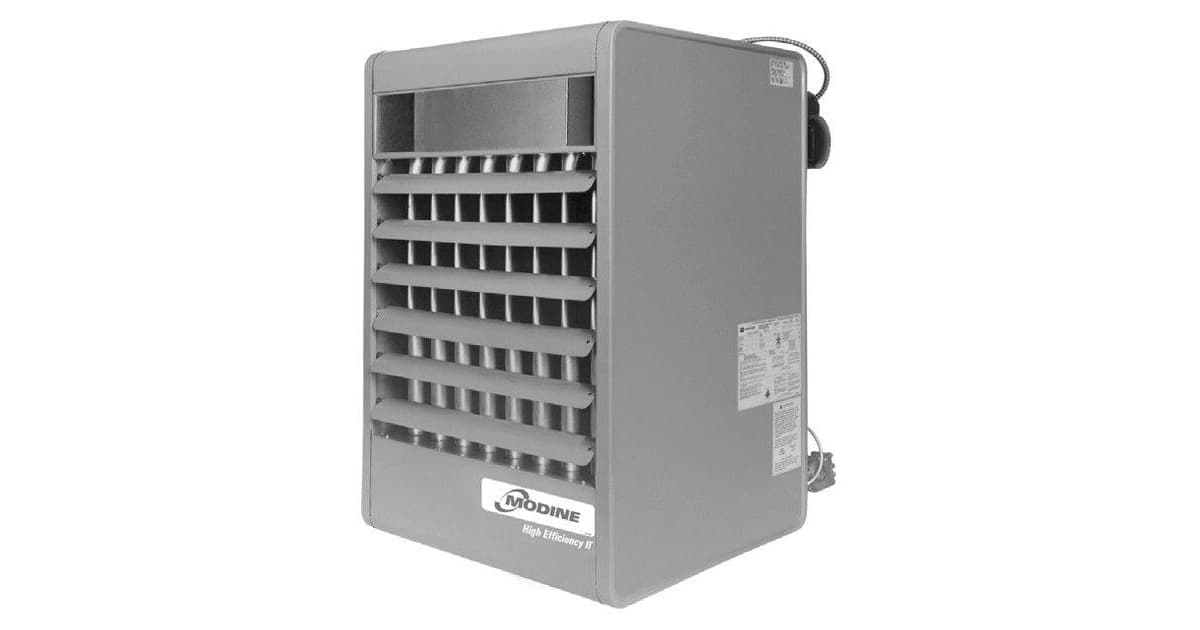

gentlemen, looking for a suggestion on type of garage heater for my shop. I'm In Mass. Shop is 26x40 wood frame insulated with a 12 ceiling. Mostly open area. I have natural gas on site. It does not freeze the plumbing with no heat for most of the week. Right now I just heat it when I use it with a 15000btu 60lb tank mounted propane heater. I'd like to go with an installed system, any suggestions?

Rinnai makes a nice wall mount heater, or you could go with a 30,000 BTU Modine or Mr Heater, but they would be over sized.

26x40 is not a large space. People heat buildings many times that size with a single hanging heater. These buildings are wide open so plenty of room for air to circulate naturally. I have no idea how you figure that it would be a problem.
I was just in a shop the other day. Probably about 40x60. Has one hanging heater mounted in the center of the back wall. Does a fine job.

I have decided to go with a gas hanger, according to the all knowing internet I need between 40 and 60,000 btu's, but since I do not heat it round the clock I decided to go with an 80,000btu unit. Right now unless anyone thinks they are NFG, I am going with a , r Heater Big Maxx MHU80NG unit with a horizontal vent and a wifi thermostat so I can warm her up from the comfort of my office.

80000 btus is BIG! You dont need that. I hope it has a modulating gas valve, b/c it will be needed.
Heating air is one thing, getting the temperature of everything in the space is another. That takes time and a bigger heater won't change that.
80,000 BTU is too much, less than half of that would heat it, unless the place is poorly insulated. I might put a 30,000 BTU in there, but no larger than 45,000 BTU.

I have almost exactly the same situation as you. My ceiling are lower at 9.5ft. I was running propane bullet/floor heaters as well and it was just not healthy or safe.
The most cost effective solution for me was a vented Hot Dawg Heater. I installed it myself to the ceiling to save money and then the plumber came in and hooked it up. If I had paid them total install cost was around $5k.
My garage heats from 32 to 57-60 in about an hour. If yours is well insulated it will go quicker. I put a fan in the far corner opposite the heater angled up to circulate air more effectively.
It's simple, cost effective and will get you what you are looking for.
