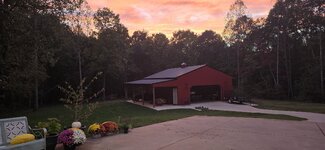

But, I built a post and beam 30 x 36 with a 12' leanto, 12' walls. Finished the inside walls with rough cut 1 x 12" x 12' pine and the ceiling with 5" x 12' pine tongue and groove, stained with Cabots Gold Mahogany. Turned out real well.

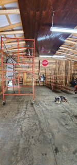

Shop pics
Early on inside. Ceiling was a pain. 2 coats stain, then up to measure, down to cut, up to install, down to move scaffold, up to finish length or measure again, and repeat.

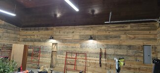

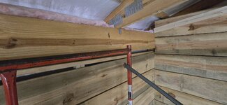

Just finished the ceiling, which allowed me to finish the wall. Also, just got a Mitsi mini split installed and going around and back into the walls to stuff insulation in the wall to stop the heat/air from going up and out the soffet. Should be comfortable once done.

Have done all the interior work myself. Added additonal framing to the structure to make the walls easier to install and make everything sturdier. Can mount just about anything I want, where I want. ;)
