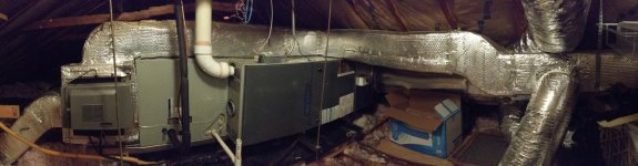

Here is a picture of an attic install done by "someone that was recommended" and a quick rundown of what is wrong. The furnace is 100k BTU, AC is 3.5T for reference (oversized, BTW). This is installed in a home approaching a $1M valuation. Underwent a gut remodel, and the new HVAC was installed less than 15 years ago. All new system, ductwork and all- blank slate.
This is just the picture, not the rest of the system:
Intake air not connected, depressurizing attic space.
Ductwork is undersized by 1/2, it is only sized for 890 CFM out of the 1500 CFM needed.
Look at the teeny tiny supply plenum and how the ductwork is attached. Bad design. That duct along the top has ~400 equivalent feet in that picture alone- not including the rest of the system. Keep in mind that this duct installation can be made to pass 2012 EC leakage tests, but it will still have chitty airflow as-is.
None of the ductwork is sealed. Energy loss plus things like sucking in fiberglass dust on the return side. Unsealed metal ductwork has an average of 30% leakage. Unsealed attic return ductwork kills 30% of your AC capacity, too.
Humidifier control in the attic.
AC condensate vent (open end of PVC pipe) is outside the safety pan.
No equipment shutoff in the condensate overflow safety pan.
No safety pan under the humidifier. Ceiling damage once already.
Flex is undersized.
Improperly defined thermal boundary. The attic ceiling (roof) is the intended boundary, but the rafters only have R-19 (code minimum is R-38). The insulation is also improperly installed (no air stops, no ventilation chutes, paper tabs stapled to the sides of the lumber vs the "top"). Blown-in insulation is used as an air stop along the ventilated soffits (not visible in this shot). The insulation on the attic floor is of no value and should not be there. The exposed kraft paper facing is also an issue. There are other insulation issues not seen in this one picture.
Technically, because the attic is not properly insulated, the HVAC equipment (condensing furnace and humidifier) should be in an enclosed and insulated room, drywall and everything. It isn't visible in this picture, but there is an open gable louver further behind the furnace, open as in open to the outside. The duct leaks and poor duct insulation keep the attic warm in the winter and make really cool ice dams. If there was an inspection on this work, I don't know how it passed.
Homeowner has hot/cold room complaints and household dust issues. Also concerned about energy efficiency.
Some of this stuff can't be "fixed" later without major work.
I almost always see all kinds of bling in a home (including this one), and never the money to fix stuff like this that is at the root of the complaints.
I'd be more worried about what you are getting in the entire home rather than what the HVAC costs.
Normally we don't consider that a condensate vent, in my experience it's treated as a clean out and in that photo there's no cap on it. Sometimes you get air noise & even some condensate "spitting" on a positively pressurized condensate pan if you don't put a cap on it. We only use it open if it's on the outlet of the condensate trap on a negatively pressurized condensate pan. Also, there's no drain line to the safety pan from the condensate pan overflow port & they even left the port plugged.
What a nightmare...
Tommy
danski0224
Jan 29, 2005
13,517
Near Naperville, IL
What a nightmare...
Tommy
Yes, there are lots of problems.
The air leak from not installing a trap can become an issue in duct testing. I don't like traps- the so-called running traps are of little value and a site-built one needs additional cleanouts. Rheem actually has a nice detail for theirs.
One other HVAC company suggested "adding a low return" to fix the problems. Absolutely nothing about the other stuff. They'll probably get the job for their "fix".
All of the supplies and returns are at or near the ceiling, which is a whole nother set of issues.
Around here that job would be 20k..
Can the system be installed in the attic?
Given a choice between attic and crawlspace, the crawlspace is the lesser of the two evils by a wide margin. Especially in this case where the OP claims to be doing a sealed crawlspace.
Attic temperatures in summer can easily exceed 140*F while the crawlspace will be maybe 80*F on a bad day.
Typical ductwork insulation is R-8. Any more than that and you are getting into hiring professional insulation contractors to do the job because you are getting into rigid insulation board over R-8.
Most duct wrap is improperly installed (compressed) anyways, so you don't even get R-8.
Duct lining is supposed to be acoustical, not for insulation value. Plus, that stuff is installed wrong too (unsealed cut edges) so you breathe it. Yum.
Lots of commercial ducting is acoustically lined *and* wrapped.
If the attic has to be done to R-38 or more, why stick ductwork that is insulated to a very optimistic R-8 carrying hot/cold air in an attic that is the opposite extreme temperature? In summer with the AC on, the duct air temp may be 50 (colder at the unit and warmer at the end of the run due to duct gain) and the attic temp is 140. Makes no sense at all, without getting into sealing and depressurization.
Probably the best product on the market for attic/unconditioned space work is KoolDuct or something similar, but it is new, different and hard to get.
Go look at an attic duct job with a thermal imager. :)

I did Spray foam and put the unit and ductwork in the attic. But our problem is the unit is too large and doesn't dehumidify the air in the summer.
