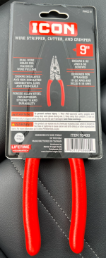

I'm confused by the wire designations. Normally 18 solid = 20 gauge stranded in all of the wire strippers I've got, and I've got a lot, so why 16 gauge solid equals 18 and 20 gauge stranded seems odd to me. Is this the way the original Snap-On version is set up as well?
willf650
Mar 10, 2010
919
I would think what is a little weirder is the #8 solid designation. I've never come across a #8 solid except bare wire for grounding electrodes.
The laser etching will probably be fixed for the next batch of them shipped from overseas.

I'm a sudo electrician that works mainly on motors and automation so I strip more wires than your average bear but many are control cables and smaller MTW. I had high hopes for these pliers with all the hype but I will tell you to pass on them after testing them on a couple sizes of wire.
I'm not a videographer and hardly ever take videos. Here is a video I made quickly on my kitchen island with my phone taped to a water pitcher. It's 11 degrees outside so I'm not going to my work bench.
Cheesey Video
I also tried these on some 12 gauge stranded THHN and the results were not as bad but you can tell the sizing is off compared to any other stripper I have used.
I had high hopes these could be a heavier duty combo stripper I keep in my computer bag but no dice. I ripped open the package but may try to return them.
I will probably delete that video after a couple days.
Snap-on combines 14/18 and 16/20.
Some at ICON had a brainfart.

Ok, didn't try any of the good strippers I use for work as they are in my truck but grabbed a few extras I don't really care for that were in my tool chest.
I also tried several types of wire. The Icons will strip larger wire OK but a lot of my realm is 18 gauge wire for instrumentation and they are horrendous for that.
Here is an 18 gauge wire out of a different type of cable. All my other strippers stripped it fine. The Icons only chafed the jacket.
Honestly the $20 stamped sheet metal Kleins worked better all around for me.

I wrote a review of this tool on Harborfreights website. It has yet to be posted. I'm wondering if they curate their review but this will be the test.
willf650
Mar 10, 2010
919
Customer Reviews: 0 - but I suppose we need to give them more than 5 minutes, right? :unsure:
(Took O'Reilly's almost 12 hours to post mine on that trashy Titan adjustable I returned a couple days ago for a refund.)
I did it yesterday. I assume if it's not posted by Friday they curate the reviews.
I've yet to see anyone actually use these in the countless YouTube videos posted. I think I commented on one of them the sizing of the strip gauges is off and I got the reply they worked great on #12 solid. I can strip a solid wire with my teeth.
I probably should have just stuck with the $20 Klein stamped steel version. They work better.

Picked these up this week for my "light" bag because they are lighter than my normal crimpers and these will handle 18 gauge. Using them right now
Those are the ones I use for most everything 18ga and bigger. Well up until the stripper that I just spin around 6,8,etc.

Those are really kick *** stripper/crimpers. They strip wire well since the strip holes are close to the handles (like your favorite stamped Klein’s) and crimp well with the crimper near the tips for maximum leverage. They combine the best features of my favorite plier crimper (Klein 2005) and a simple wire stripper. Truly cut, strip and crimp wires properly in one tool when you’re trying to keep your bags lightweight or do more with less.

I think it's funny that Harbor Freight is cloning an unpopular Snap On stripper/crimper. We have the Snap on version at work and they gather dust. No one likes its size or shape. I'm sure they'll sell but, just seems a little strange to me. :dunno:
29,350
You and me both.
After a couple of the comments above, I am glad that the local HF was out of stock.
My buddy is still using my old Belden crimpers I bought when I owned the Opel.
I'm still using an old beat-up pair of Kleins. I know there's at least two or three more pairs here somewhere - Kleins and ProAmericas both.
Just sold the "Cal-Tech" (Taiwan) cheapies a couple days ago.
I just don't see this HF model being a hot seller now that the word's out on it not handling smaller gauge wires properly.
