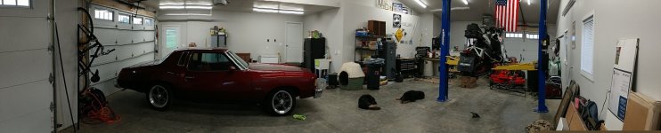

I just built. 1800 sq ft house. 1800 sq ft garage. One story with a walkout basement. Long wall of garage is north. Have a door in master to walk out to covered patio. Also from living room. Just something for you to look at. Pretty happy with how it turned out:thumbup:
Hey Slim, did you do anything special to keep you sink supply pipes or drain from freezing?
slimcake
Sep 27, 2016
929
Ya I put in a furnace. Actually 2 if you consider the Mini-split ac/heat pump. Is that what you're asking?
