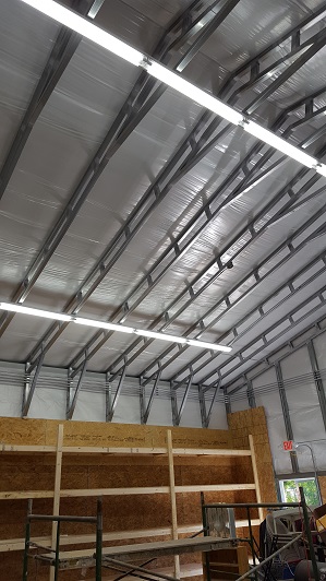

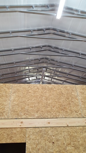

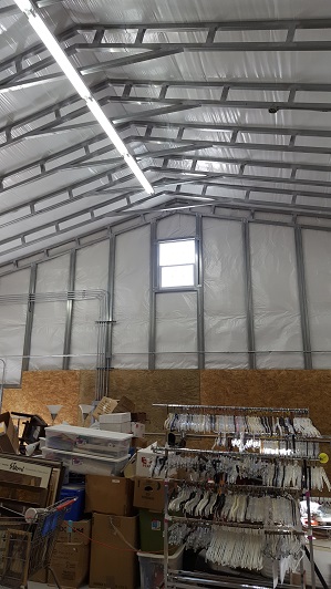

I had mine built by Superior metal structures and concrete. For the budget that I had it's as good as I can get
I'm in the Rocky Mount, NC area0a7edc0279d1891c4edc99e6e1222c73.jpg35763ba96a1f2b64c391db12302ac751.jpg20aad23606719bb6814ecf458f676bc3.jpg
Sent from my Pixel XL using Tapatalk

Were you pleased with Superior? I like the red iron buildings better but I'll get more space for the money with this prefab style. Did Superior sub-contract the electrical or did you handle that?
Sent from my SM-G920V using Tapatalk

Electrical is done myself. 60amp service.
Not really anything to complain about.
My trusses are 4ft centered instead of 5ft.
(Pretty happy about that)
