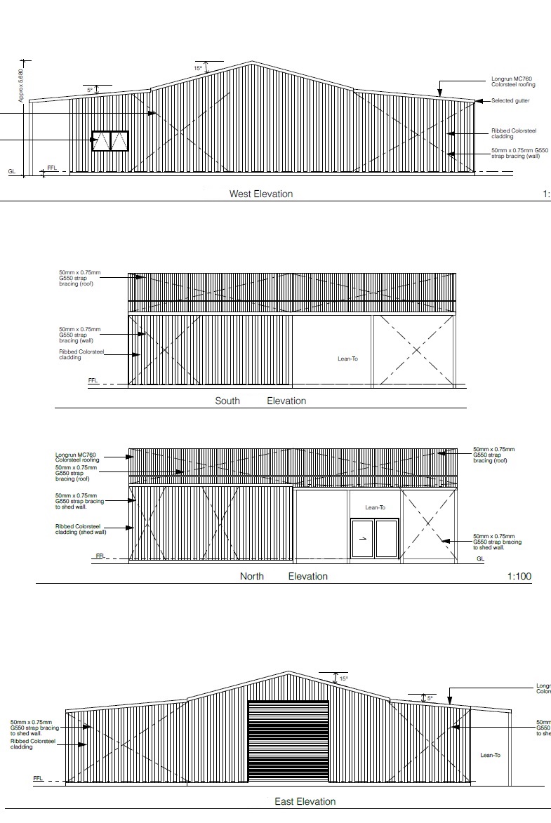

My shed is a new build. timber framed and tin covered with concrete floor. As large as could be afforded with the internals to be done by self later. Have a guy i've known since a kid that has a shed business to erect it.

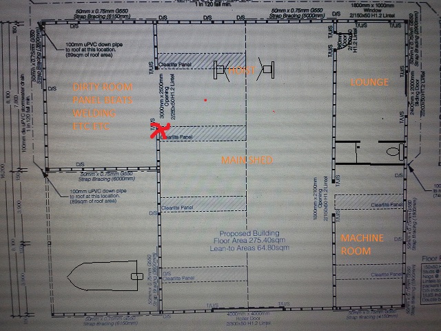

20x16m total footprint. 10x16 gable roof main room, 4m stud 4x4m roller door. 6m and 4m leanto's off each side. 4m side fully enclosed and split into two. one for machine room the other lounge area with 2m roof overhang and ranch slider access. 6m side is half enclosed for dirty room with 3.5m wide doorway into it from main room. the other half as an open leanto for boat etc. Tin is NZ made coloursteel in karaka green. (think british racing green).
This plan i thought, should cover all my metalwork antics. I tinker with 70's/80's toyota mostly. but forever making/repairing things. I'm a total DIY person. If I don't know how it's done i'll research it to death and then do it.

first thing for any mechanics on here.. where would you have the hoist?
I'll likely have cars positioned down the sides leaving an accessway down the centre to hoist. Problem encountered was then access into the dirty room impeded with the hoist in use. so looking to widen doorway (red X). want to be able to push a car in there.
thoughts?

If i was setting up the hoist I'd possibly look at pushing it towards the top right corner of that room a little more with a slight angle on it just to help clear the dirty room door a bit more. Key thing will be making sure you keep your access ways clear to it so you don't block your own access to the hoist.

Ok so went with the central location for hoist and 3.3m from the end wall. (A bit closer than a 4 ton Molnar clear-floor manual recommends at 3.6m but oh well). Instructed builder to widen the side room doorway to 3.6m as per plan above.

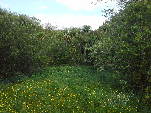

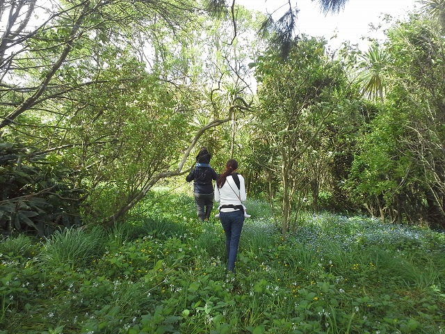

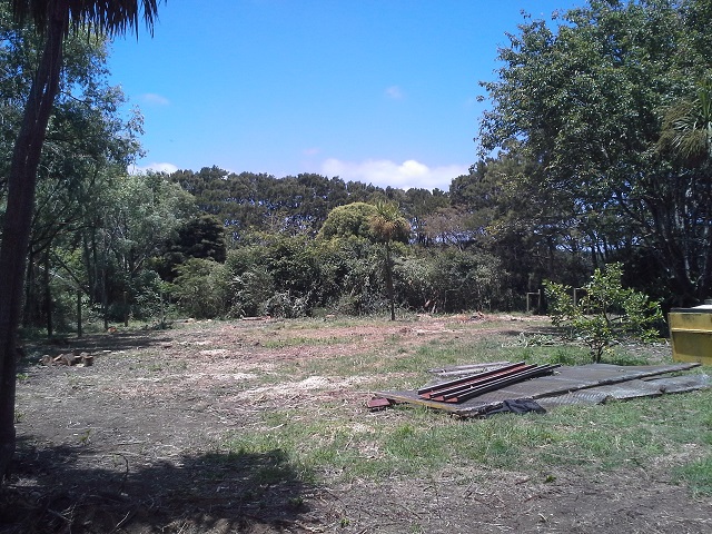

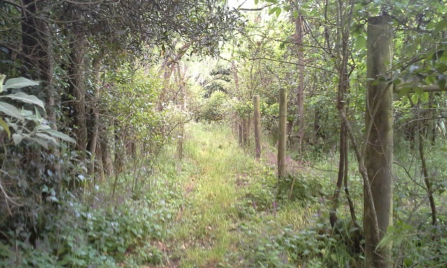

So back in october 2015, I took some snaps of the property when we first inspected it. When the decision was made to build a new shed we then had to clear a space for it.
Looking down from the original garage.. those trees all gota go! We kept the little lemon tree in bottom right.
After. lemon tree survived the chipper. Now I can pretend to be Burt Munro :thumbup:

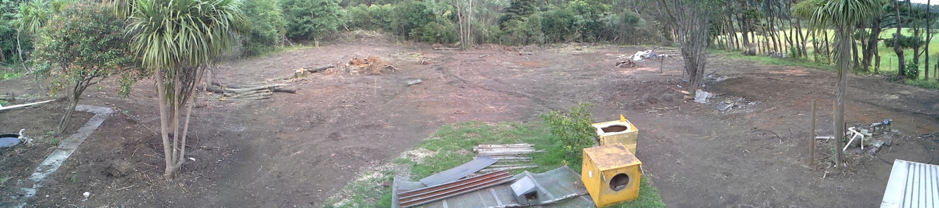

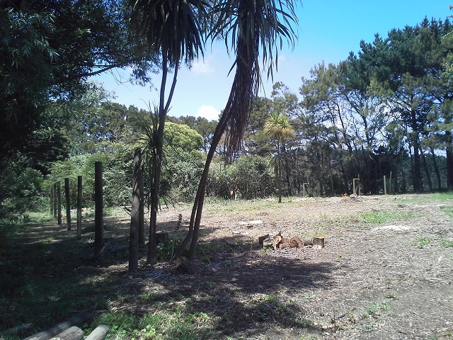

The place had rows of galv wire strung between posts and access ways at the ends.
After

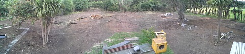

This will be a recurring progress shot. shed will be centre/right
After. The overgrown pear tree on left was kept.

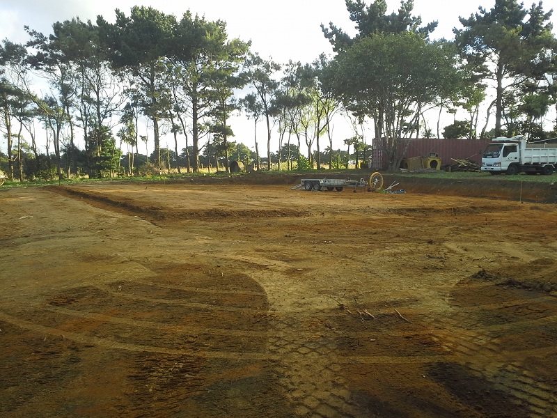

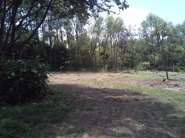

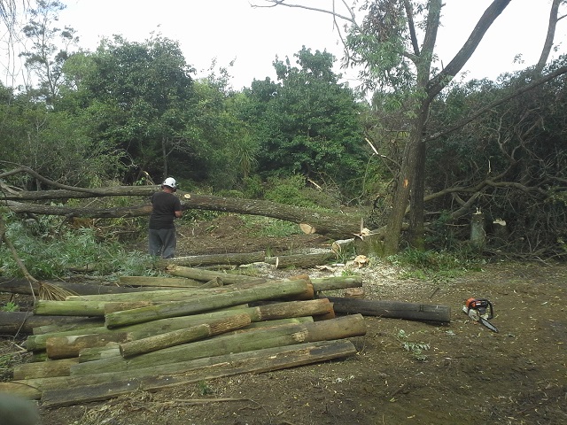

Measured the area and it wasn't yet big enough. So the willows in background above got the chop
Clean canvas! There end's the scrub clearance mission. And the end of my christmas holiday break.

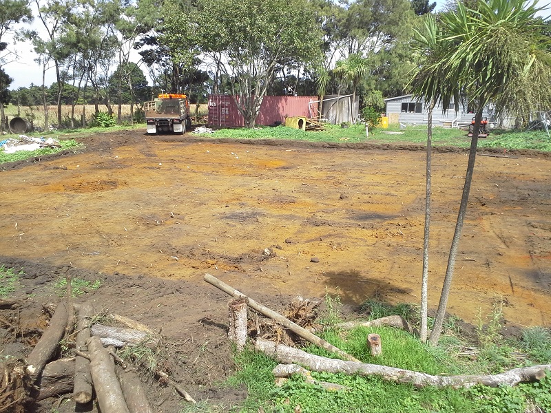

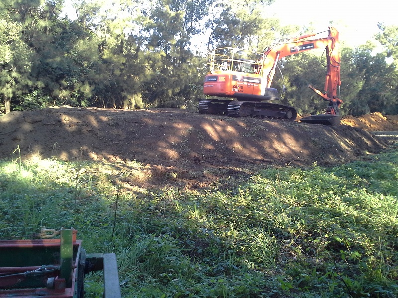

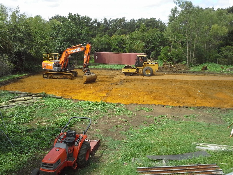

landscaping work done by contractors.. two 20ton diggers, two 6 wheeler dumpers and a compactor.

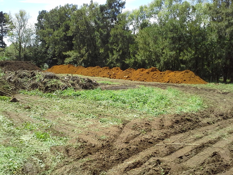

Last of the biggest tree stumps pulled with digger then top soil removed.
top soil dump. We'll use this later for gardens.

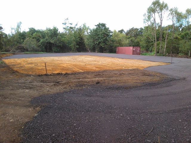

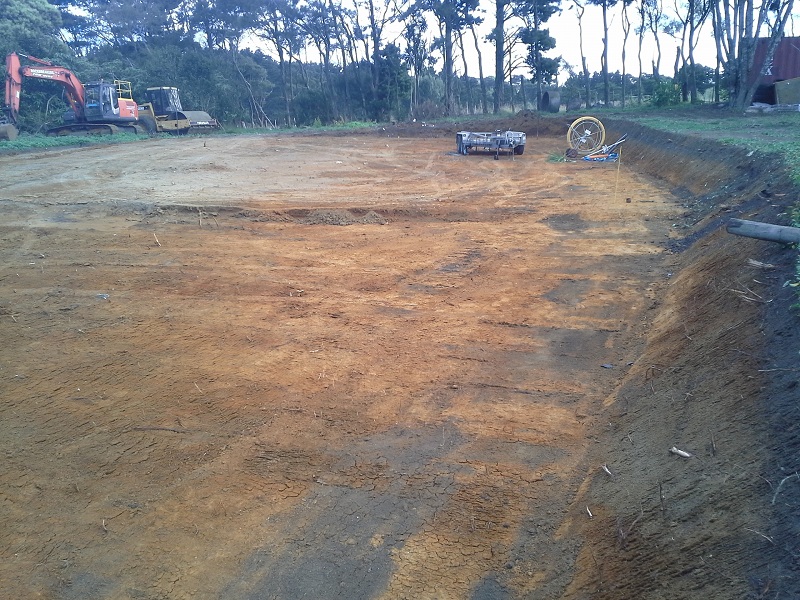

Site cut and levelled about 30x50m. Back filled and compacted just the lower side of shed pad about 50mm. The shed site is up 250mm from surrounding area to allow for surrounding metal. 300mm thick metal compacted. More than i'll ever need but was recommended by my arborist brother and the contractors as there'll likely be trucks driving into the shed.
Site cut. Shows the meter depth of cut at top side.
That concluded day one. :eyecrazy:
Clay taken away too. But this wasn't supposed to happen!! I made contractors move it back and compact it to level out the driveway access around the bottom entry side of shed (left side of above pic). No way was I going to push a powerless car into my shed up a slope!
Surrounding areas slagged. There's a 1/2m drop off at the bottom but we'll fill/smooth that later. We use crushed slag for driveways from a local steel mill. Mixed grade gap40. Much cheaper at about $8/ton. But with 980tons going on the property including the front shed it was a large part of the total site prep cost.
Lessons were learned. Don't trust contractors will do exactly what you request. Ideas and instructions get miscommunicated. They pull shortcuts and if you're not watching it'll be too late to fix. I would've had a dirt wall in front of my open leanto, a cambered out driveway that was barely driveway width, far from the turning room i needed to access the shed with a truck, and a pile of clay dumped 200m from where it should've been put and compacted.
They did a great job otherwise. Glad we got the big boys in. That would've taken forever with a 2.5ton digger :D

I think you'll find access to the dirty room is not too bad if you have the car on the lift raised.

Yeah i'm happy now with access. proof in the pudding though. And a car in the dirty room will likely be there a while so it's not a high traffic area. Ive got plenty of rusty cars. Or should that be Ive got cars of plenty rusty. lol
