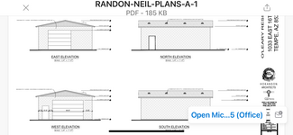

Are you sure about the light switches?
Zero switches by one of the man doors seems like a mistake.
100% of the lights all coming on at the same time also seems wrong.
Consider often you may run in to grab one tool or to check something and only need one light over tool box.

With a garage that size a single bank is ok, at least to me. My current 3 car garage/shop is all wired to a single switch and it doesn't bother me.
I agree that a three way switch at each door might be useful. It depends on the planned use of the other door.
Congrats to the OP! You might want to remove your address from the drawings.
N
no704
Apr 27, 2016
5,259
Thanks for the reply’s. That’s just bare minimum on the wiring. Plan to add as needed, will be exposed EMT.

You guys can know where I’m at, how else are you going to attend the grand opening party!

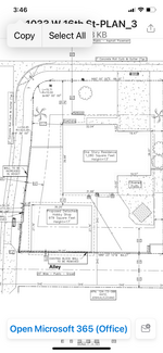

City wants an additional 4’ backset from the property line. Original dimensions were drivin by the location of the main sewer line. So I guess I’ll be 4’ shorter on the depth. Unless someone has a great thing to say about having a 3”sewer line running thru the footer at about 10degrees from parallel?
I’d rather have the shop space and go over the sewer line. My attached garage was built over the line. Building inspector made the builder sleeve the line at the footer.

I put my shop over a sewer line, its a 24'x36' and I would have lost 7-8ft out of the 36' to miss the line. Wasn't thrilled but glad I didn't lose the space, still don't have enough. Also had to put in a sleeve for the line going through the footer in two spots.

Sleeve the line in preparation for future problems you'll hopefully never have and proceed with the larger shop.

Do you really need that man door on the garage door side? I'd center the garage doors, that offset is kinda odd.
N
no704
Apr 27, 2016
5,259
Don’t really “need” it but that will be the only side exposed to the street. The rest will be inside a block wall fence.

Might apply for a variance to keep that 4’. Doesn’t sound like a lot, but that’s a workbench!

So the 5’ setback on the west side needs to 9’ from the city. Not really keen on building over the sewer line. What do you guys think ? And the electrical over head is right there too. Might just end up with a shallower shop😩 still be 31x27, lots bigger than the one I have now I suppose.
carcruse
Apr 7, 2007
224
SE Michigan
no704, you show 7' between the house and shop, does that meet code? In my area the minimum is 10' house and accessory building (shop).

I did the offset OH door in the gable end also. Having a larger workspace on one side was 100% necessary.
I wanted a man-door next to the OH door also - but that didn't fly. Took away too much strength from the wall. Man-door ended up on the side, just around the corner.
thammel
Oct 3, 2005
2,259
Maryland
