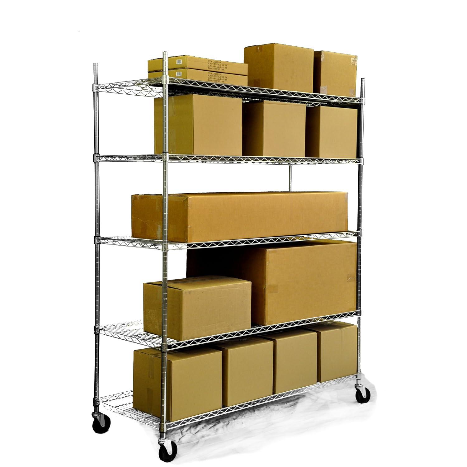

Store all of your junk on wheels. You can move it out of the way in seconds. I have a storage unit and these shelves are a lifesaver.

Junk on wheels ...I like it!
