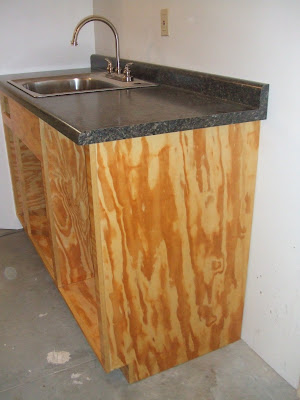

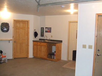

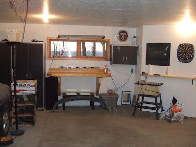

This project is pretty much a continuation of my other thread where I detailed the build of the utility closet in my garage:
http://www.garagejournal.com/forum/showthread.php?t=22763
There was already a drain in my garage for the emergency overflow for the floor heat boiler. I saw this right away when I was looking at buying the place and started thinking about the possibilities. :drool:
Here is a link to the entire album:
http://picasaweb.google.com/lucasdotcom/GarageSink#

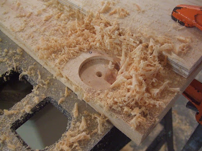

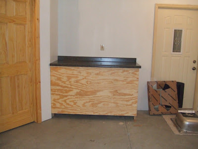

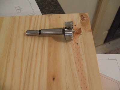

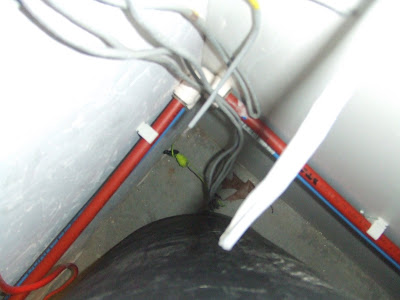

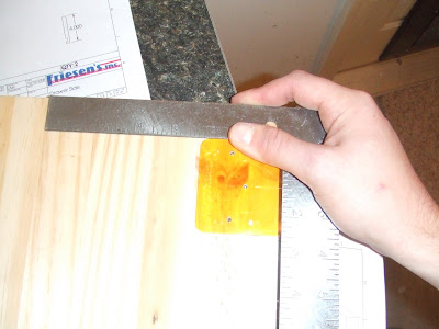

I still need to get a towel holder and few other little things. The biggest thing that I need to do is clean everything up again; sawdust, PVC dust, dirt, and varnish are pretty much covering 95% of the garage right now. I’ll take a few more pictures and add them to the album once I get everything cleaned up. I learned a lot of different stuff on this project. Nothing was really that hard. Plumbing the drain was a bit of a pain because I had to deal with all of the floor heat tubing, but it turned out OK. Making the drawer was a little tough; it didn’t fit right initially, but I was able to massage it with the table saw. Oh yeah! The big hole under the counter on the right had side is properly sized for a fridge that I can get at Menards or a “beverage center” that I can get at a few different places.
Lucas

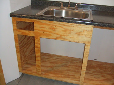

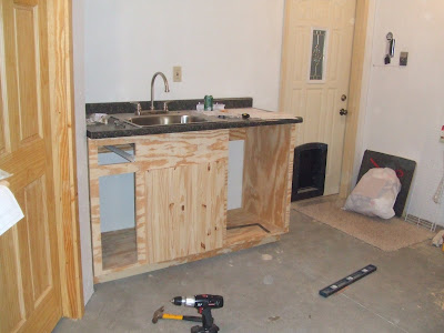

After getting the closet finished up I bought all of the supplies for the garage sink.

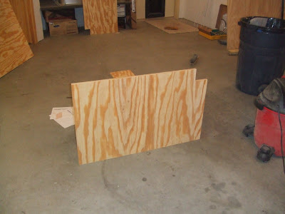

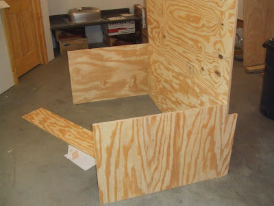

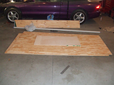

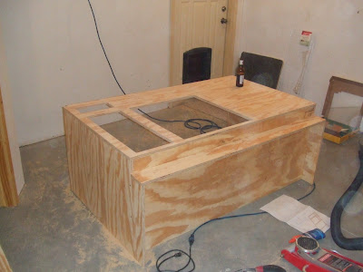

Here is the cabinet taking shape:
Making the doors:
Done and ready for finishing:
Varnishing:
Varnishing and edge banding done:

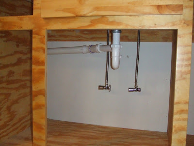

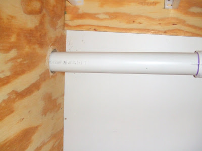

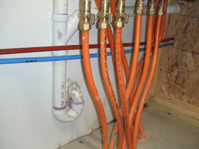

Plumbing the drain:
Plumbing the supply lines:

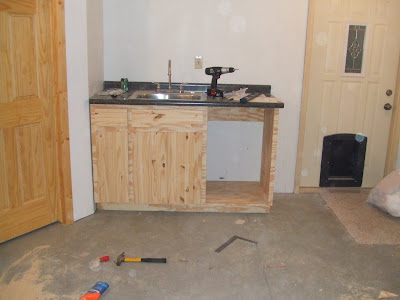

Putting everything back together:

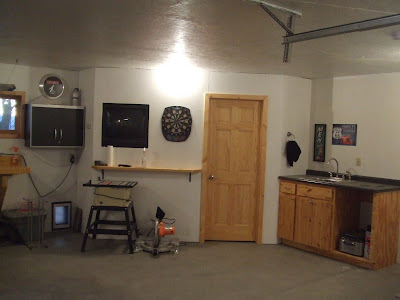

Here are the final pictures after cleaning up:

Wow....looks good!:bowdown: Is the opening on the right side for a small fridge?
Yep! Beer Fridge!
Looks great but how/where you gonna run the power cord for the "beverage centre?"
Marc
I thought about cutting open the drywall and adding an outlet inside the cabinet, but I'll probably just run an extension cord into the utility closet where I have a free outlet. If I do this I'll drill a hole through the bottom of the cabinet to keep it clean looking.
Lucas

pipehack
Feb 23, 2009
923
chicago
nice job....... Although the plumbing job should Not be doubled trapped that way. the one you have under the sink is enough . and your tie-in with the p.v.c. wye could/should have been a sanitary tee. That could fail if it ever got inspected. I know the chances are probably slim to none. I'm a union plumber by trade and the plumbing codes in chicago are very strict. Hell, we still have to use cast iron , lead and oakum in commercial work. I am not nit-picking at anything OR anyone here I think everyone here is very professional and courteous on this site. Just thought I'd give my .02 . I would get rid of the double p-trap though.
