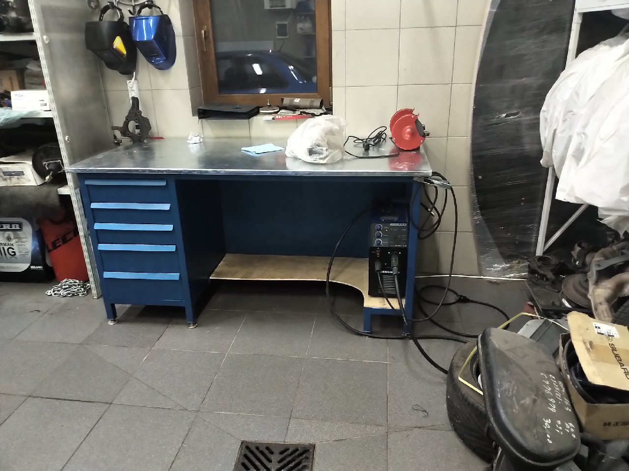

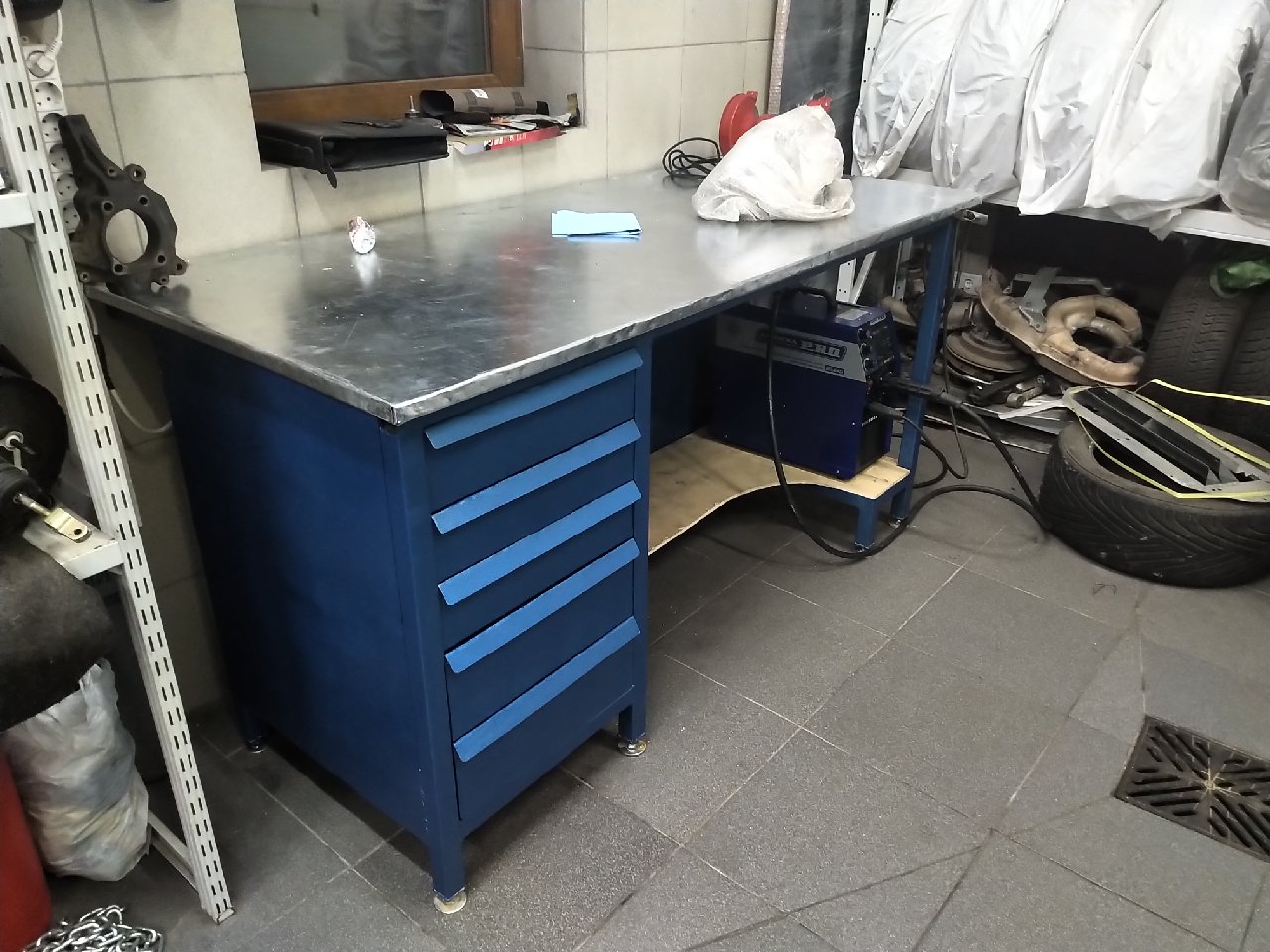

I finished fabbing a new table which will be used for cutting/hitting/welding, basically anything that doesn't require high precision)
Need some tips on:

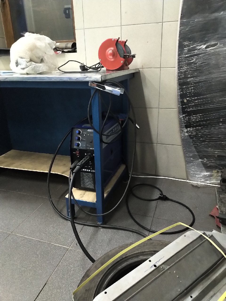

1. how to fabricate some kind of side mount/holder for the welder gun/hose to go around, and ground wire too
2. given the vices will probably go on the right edge of the table, what is the best way to mount the bench wheel grinder? I found some solutions where it can be installed on flexible mounts and can be tilted and hidden under the table, but not sure if its the best solution - I don't use it too often

For your welding cables, when I built my welding cart I just cut and welded a couple of pieces of 1/4" round stock to each side to wrap my cables around. Simple to fab and works really great!

What I did is I put receiver hitches all the way around my table and made mounts for all my vices and my bench grinder so they just slip in and you can pin them in and my gun holder is a little piece of 1 in. Square tube you can see in the pictures

I thought about that, but I think I will leave the vices stationary because I am not a fan of free lifting)
the plan is to install them on the right front corner
as for bench grinder, this can probably work if I can find a square tube that can fit inside the table tubes
wonder if putting it on the right side where vices will be is a good idea, since its a temp solution which will be plugged in only when necessary? although grinding on top of the welder might not be a good idea with metal **** flying into the fan fins
