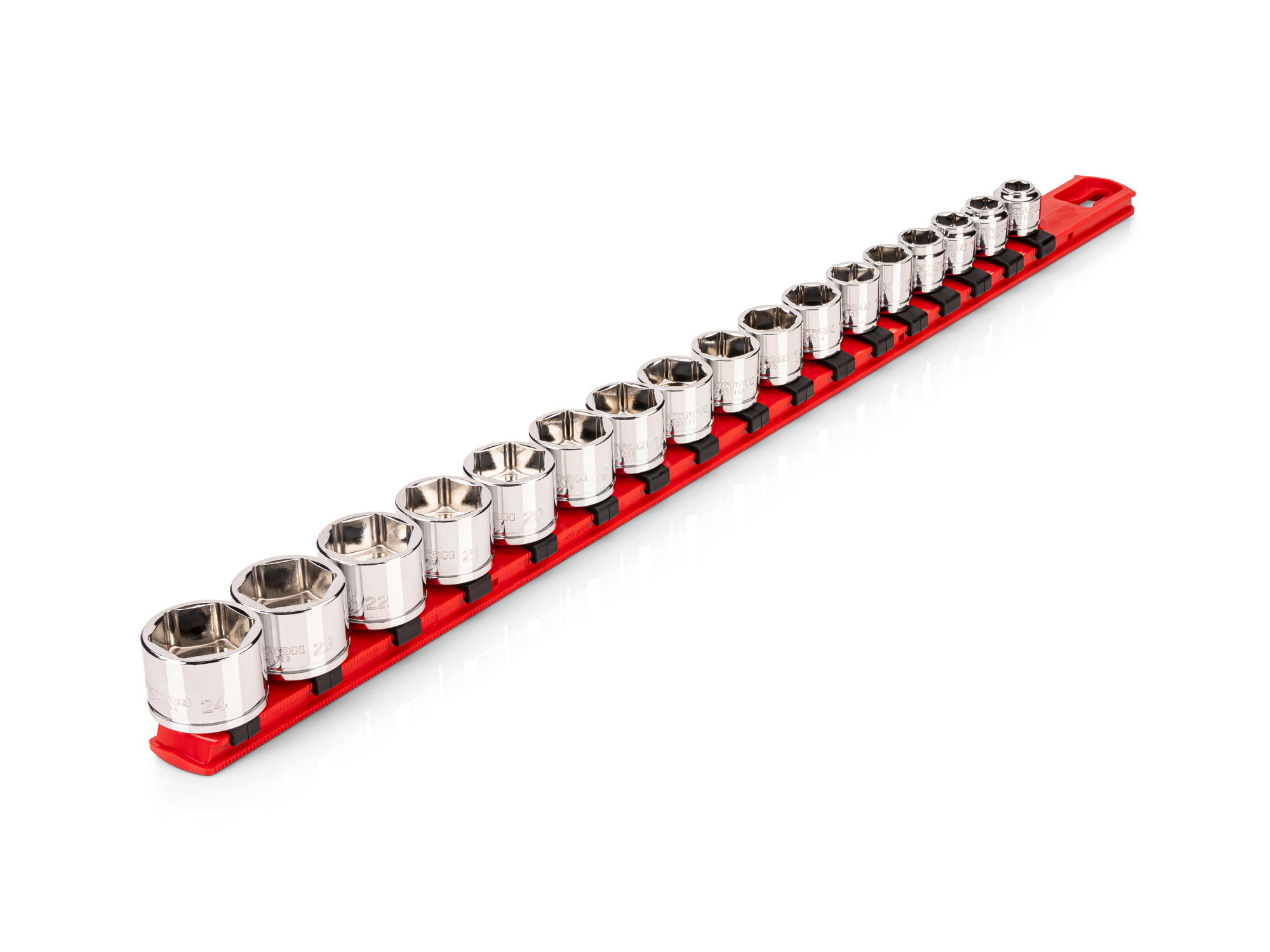

Greeting all, I did a quick search, but nothing came up. I apologize if this is a duplicate post. Tekton released a couple of new items this week.
First were stubby 1/4 drive flex head ratchets with or without quick release. What makes these interesting to me is there's a male 1/4 square drive tang on the end of the handle. Now, this could be a way around other brands' patents :dunno: The tang offers you the ability to attach various; length extensions, bit holders or anything else 1/4 drive. Could be useful. I think $40 is on the high side but, that's close to what a NORA version is.
Followed by 3/8 drive extra shallow six-point sockets in SAE & Metric. I don't think these sockets will inspire someone to give up their Zeal sockets but, the range out to 24mm in metric or one inch in SAE is impressive to me. I do like the availability of individual socket right away too. I'll wait for a side-by-side comparison with Astro nanos on you tube before picking them up. :beer:
