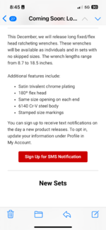

Not me. CMILES217 added it to the thread I made about new Tekton releases
I'd like to know more about the lengths of the wrenches. They're advertised as long not X long so, that's a good start. I'm sure the specifics will be revealed once they're released. Tekton is really good about releasing tool specifications. :beer:

Not what I meant. That's like an initial press release. What I'm referring to, is Tekton publishes a chart listing dimensions for each wrench by size. The chart will come out once the wrenches are available for sale. I'm hoping that the core sizes (8-19mm) aren't too long. I really want a standard length version. Like an 8 inch long 13mm wrench for example. Their current 13 x 15mm double boxed end flex head ratcheting wrench measure 15.9 inches long overall which I find to be too long in certain applications. :beer:

First time I've seen trivalent chrome advertised specifically.

I believe Infar makes the other Tekton ratcheting wrenches currently so, they would probably make these as well. I hope the measurements above are for a different series of wrenches though as Tekton lists their lengths as starting at 8.7 inches long to 18.5 inches long for the new wrenches. :dunno:
