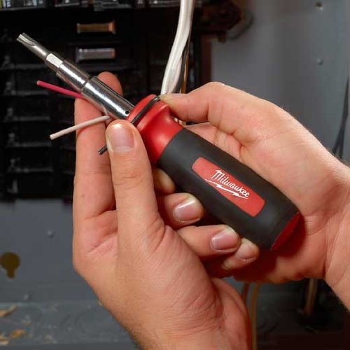

I also bought a Milwaukee screwdriver recently that has that bit, they call it a ECXbit...

Milwaukee calls this tip the ECX...available as a screwdriver, bit insert, etc..
Just another point to make...there is also another version such as on the Whia which is called "Terminal Tip":
They are NOT interchangeable... Depends on the fastener in question, I've got both, and in my wiring of my garage, I found I used the Whia Terminal tip the most...every recep/switch/etc.. had the terminal tip style, while all the connections in my Square D panel used the ECX type. Just fixed some extension cords with new Woodhead ends and sure enough Terminal Tip.

I have the Milwaukees and the Masterforce (Pratt-Reads), they are definitely the best option for electrical receptacles, Square D breaker screws, etc. Personally I wish everything was torx, but since this is existing stuff with those, the ECX-style is the best option.

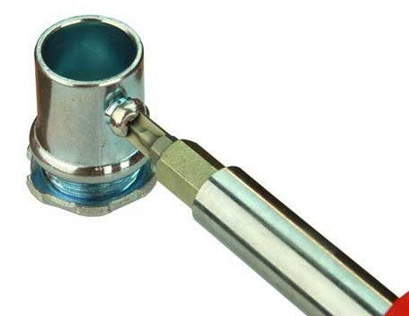

I like using the cheap and easy to find DeckMate bits from Home Depot. They work great for conduit coupling set screws that use a #2 phillips/#2 square/flat combination head. The hex bits are usually easy to find because they are a bright blue color.
For things that use a flat/square drive combination head without Phillips (like panel covers) I use a square bit. They are usually very low torque items anyways.
For the larger conduit couplings that use #3 square/Phillips/Flat I use a #3 square bit.
