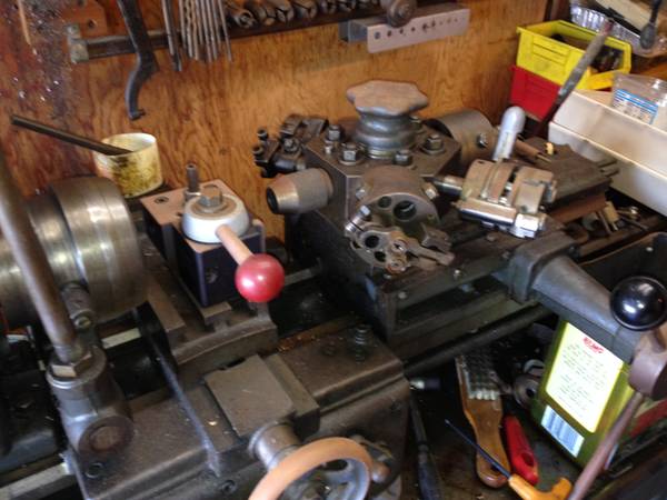

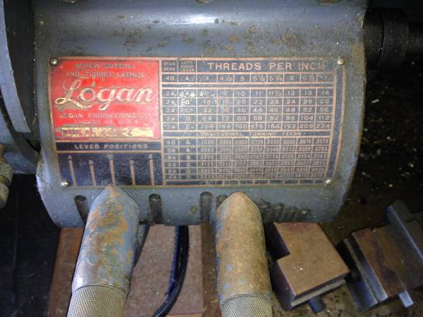

Hey Kevin,
Yes I did end up with the lathe. It is a 1949 Logan Model 845-A 10" Screw Cutting Turret Lathe with upgraded production collet attachment and add-on production tail stock assembly. It also has a Phase III quick change tool post and probably a bunch of other things I have no idea what are. I took wood shop in high school. I have no idea what I have gotten myself into here. :lol:
At somewhere north of 1000 lbs it was a fun move and I didn't think to take any pictures as I tore it apart. I definitely need to take some now and will post them next week. I have temporarily reassembled it pending a complete tear down and thorough cleaning.
It wasn't the model lathe I went to see. He said it was a model year 1955 11" lathe. What caught my attention however was he said his father, a machinist, had had it since it was new, at first in their Seattle basement and later in his SoCal garage. Knowing nothing about lathes myself, buying a lathe with such a known history made sense. I'm not sure if that story is true however, as the 1949 date doesn't make sense. The son eventually admitted he wasn't sure either (after I had paid for it :wtf:). I suspect his father acquired this lathe in the late 90's as there is a receipt for a replacement user's guide and a bunch of parts. In either case, he would have known what he was buying and I have to trust in that. All I know first hand is that the ways look really clean directly in front of the head stock so whomever has used it over the years appears to have known what they were doing.
If it turns out to be the wrong lathe for me, or I find a deal on that 11" lathe I was looking for in the first place, I have no doubt that I will be able to get my money out of this first one.
At present I see one missing (gear) tooth, a broken hinge bracket on the head stock cover, and a mickey mouse replacement for the carriage lock. All easily replaceable items. Thank goodness for YouTube's mrpete222. He is a former metal shop teacher with a youtube channel. With his help I pretty much knew what I was in for when I started to disassemble everything. My only uh-oh moment was when I realized I had no idea how to remove the two belts that drove the head stock. Ended up cutting them figuring new belts were going to be less expensive than a trailer rental. Turned out they needed to be replaced anyhow. The whole thing fit into my Expedition in two trips, including the HEAVY steel cabinet.
So the best I can do for now are pictures from the seller's ad.
