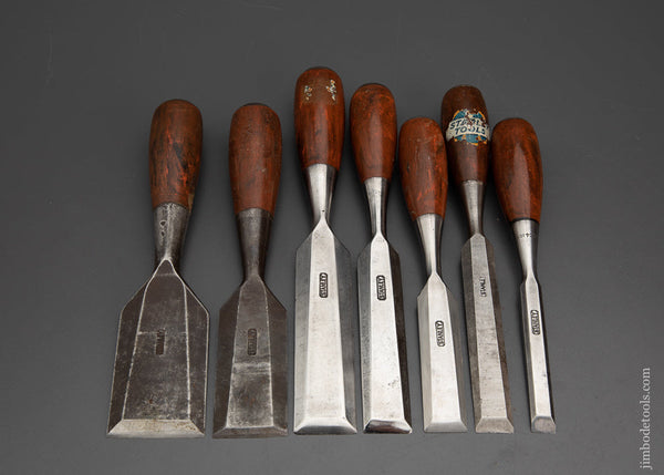

I noticed the lack of gap too and the solid core/capped **** you referenced made sense, but these aren't wood handled. They're a composite made to look like wood. It looks similar to old style CutCo knife handles.
Here's a photo swiped from the Jim Bode tools site. He refers to them as composite handles.
There's quite a bit of color/swirl variation in the CutCo handles, but this photo shows that style.

tough call there, looks really close, still waiting for the OP
Any clues as to when those were made / sold? Not finding them in a quick poke thru catalogs, will try again later. Just checked my Walter’s Bible, he doesn’t list them, so may have never hit the catalogs.
