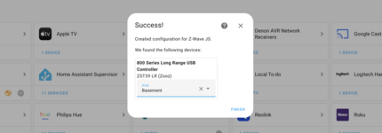

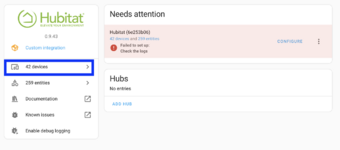

My Hubitat has been freezing up again :mad:
This lil' guy here:
As a refresher I've been awkwardly running two smart home platforms in tandem for several years now. Home Assistant, and Hubitat. All my Z-wave and Zigbee devices are paired with Hubitat, because that has the radios for it, and then everything else that is WiFi or LAN is paired with Home Assistant. And then I'm using a 3rd party integration for crossover between the two.
Originally, after I left SmartThings, I rebuilt ALL my automations in Hubitat's WebCoRE, because I was familiar with it already. But as I got more used to Home Assistant, and its own automation capabilities made some leaps and bounds, I started adding and migrating automations to that.
If that sounds really messy, it was. Since January this year I'd been working to rewrite all my automations in Home Assistant alone, and use Hubitat only as the device bridge for my Z-wave and Zigbee devices. I pretty much got to that point.
And then this past week Hubitat started completely freezing up. No devices would respond, UI admin page wouldn't load, etc. I'd have to pull the power to force a reboot. And then everything would work for a day or two until the next freeze. This is the 2nd time this has happened to me.
And then last night, pulling the power trick didn't work. The status light comes back on green, but no admin page. No connectivity. I think it's toast.
I am NOT going to rebuild everything in Hubitat again. Too much effort and am skeptical I have a dud or it could happen again. Plus, the 3rd party bridge integration I use... I can't rely on that to be developed forever. And it just makes sense to keep everything (devices, automations) under one roof.
So I'm going all in on Home Assistant, for real.
Home Assistant is a bring-your-own-hardware adventure, and the mini PC that's hosting it in my basement closet doesn't have Z-wave or Zigbee radios.
So I just ordered:
SMLight SLZB-06 PoE Zigbee 3.0 Coordinator
Zooz 800 Series ZST39 Long Range Z-wave Stick
Now to wait until those show up and figure out how to re-pair everything again and probably edit all my automations that had those devices in them. Truly dreading it.

So I got both 'coordinators' (Zwave and Zigbee radio antennas) in the mail today. They are completely separate setups, so I decided to tackle the Zwave first.
This is mainly for @cccoltsicehockey , so feel free to jump over it if you don't care!
Wow, the Zooz 800 is small!
I installed with a USB 2.0 extension cable to get it away from the computer (this is recommended).
Then I installed the Z-Wave JS add-on, and the Z-Wave Integration to Home Assistant. It found the Zooz 800 stick no problem.
I wasn't sure how to go about re-adding the devices. A couple issues:
— if I 'disabled' the Hubitat devices, they still show up in the automations, cause duplicate names if I retained the names
— if I 'deleted' the Hubitat devices, it would only let me delete some of the entities for some reason
— if I tried 'renaming' the entities, some weird conflicts and anomalies started happening
So I tried to make as many screenshots and notes of how my devices were named, and the automations they used. And then I removed the Hubitat integration altogether, which does scorch earth on all those devices and entities.
I will say, this had me a bit nervous.
Afterwards, I spot checked some of my automations, and the former Hubitat entities were no longer displaying in the UI editor, but YAML only.
It was a mixed bag. Some automation triggers I had renamed with a description (like in the green bubble), so that was helpful. Others (like in the red bubble) I had no reference to a 'friendly name'. The YAML listed the old ID numbers... but I couldn't find reference to that anywhere, especially since those devices had been deleted.
Here's an example where I really lost any reference to what the device was, other than it was a 'light' domain:
So basically... deleting devices makes automations that used those devices pretty confusing.
So not only did I have to exclude each Z-wave device, re-include it, set up any device configuration, give everything new names, but I also had to go through all my automations and rewrite the portions that were referencing the old, deleted devices. A PITA for sure.
I will say that the exclusion and inclusion process was very easy, and probably the most responsive of any hub / coordinator I've tried.
I did lose some of the more intricate configurations on my devices (specifically dimmer switches and power meters), so I'll have to fine tune those again over time.
But, everything was recognized and seems to be working. So YAY for the Zooz 800 stick.
I got everything done, including automations redone, in about 4 hrs. But it's not my first rodeo.
Now I have to figure out the SMLight ZIgbee one and do all those.
TL;DR Immediate impression is the Zooz stick works, and if you are going to migrate, I strongly recommend doing it before you write your automations in Home Assistant
