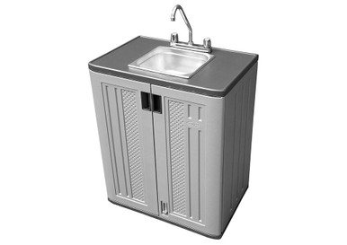

Reviving and old thread. My shop is completed and has no running water so I'm also looking for a portable solution. Is there a commercially available option I'm overlooking. The one in the link below is a self contained unit but a bit spendy.
I'm not completely opposed to one without hot water but it would be chilly as I maintain about 60 degrees in the winter.

Someone suggested a "Water Cooler Stand" with the 5 gallon jug on top. The reasoning is, those also have a "Hot Water" tap. This way you can wash your hands. It drains into a 5 gallon bucket you dump occasionally.
