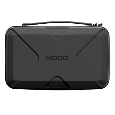

1320
Jan 3, 2018
910
Arizona
1320 -- Looks like NOCO sells a case for the Genius10 at $25:
I have their cases for both of my units and they've held up well so far.
Somehow I missed that, thanks.

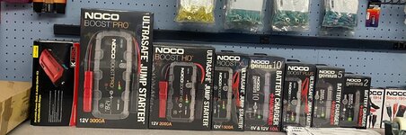

Thirdyfivepickup
Nov 15, 2016
1,962
Portage, Indiana
We have been selling them at work for a while now. We have had great luck with them. I currently have a few on the shelf. The brand is growing stronger as I've had a few customers come in to our store (primarily auto parts) looking for the NOCO brand.
