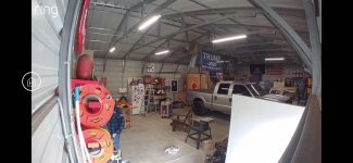

DeeDubz
Nov 20, 2019
1,460
Socal
I have a stick up ring camera that I put above my door. It sits on one end of my shop. I can see 90% of the space. It has motion alerts to your phone and records motion. It also has a audible alarm. I paid 100bucks for it.
