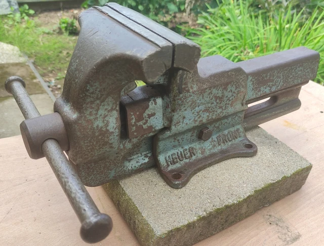

Most Euro vises,
even if made with a square or rectangular hole pattern for fixed bolting to a bench, have a rotating base as an option nowadays, and this includes both Gressel and Heuer.
Both manufacturers also make lifts for their vises, which allow the vises to be raised snd lowered in height, and rotated as well, and these accessories have been available for decades. (Probably at least 40 to 60 years or more)
The US swivel designs seem like a continuous progression in design once the side bolting tabs were done away with.
The center threaded hole in some vise designs like the Morgan and Wilton vises that fasten the vises to the swivel bases seem like a direct evolution of the older designs were the vise was both connected to a bench, and allowed to swivel on that single center bolt, by tightening or loosening a large bolt bolt or hand screw under a workbench.
At some point, someone realized that dingle center bolt wasn’t sturdy enough, or loosening or tightening the vise when rotating the vise was a pain when the nut was under the bench, so a cast iron swivel base was designed that could be rotated, tightened, and loosened with nuts on top of the vise base.
The threaded center hole in the middle of the older vise designs stayed though, and is used to hold the swivel base to the vise.
More recently designed vises tend yo lack that threaded center hole.

Most Euro vises,
Yes but they're an add on, not the norm. Gressel and Leinen and Schlegel all look VERY awkward on them and get raised up a bit too much for most regular benches.

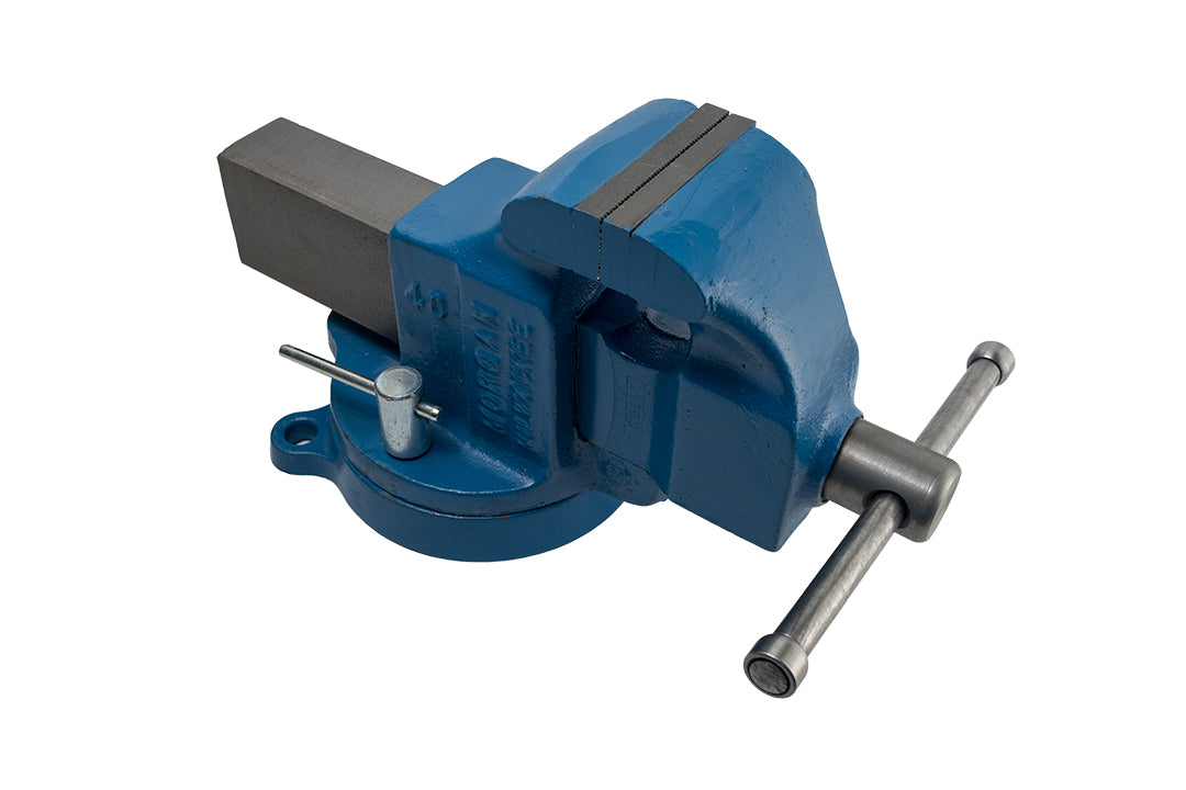

So I'm narrowing it down to a couple new vises, should I opt to go that way, and on the used/vintage/antique side its a matter of knowing it when I see it.
I'm leaning very hard toward an Olsa/Capri 7" forged steel vise. It is Taiwanese but seems to be of quite good quality and is a very good value coming in under $400. The USA made vises are just too damned expensive and from alot of destructive testing videos I've been watching they aren't worth the $1K+ the manufacturers are asking. The Olsa has a couple deficiencies where they cheaped out a little but they are somewhat easily addressed from what I can surmise. The materials and basic engineering seem fairly top-notch.
Other contenders in the new category are the Brockhaus Heuer 180 and Rigid F-60. Both are manufactured in Germany and are of excellent quality. The Rigid is actually very similar in design to the Olsa/Capri. Prices seem to range between $500-$600.
The Brockhaus is of the Heuer design and the 180mm (7 inch) is in the $580 range.
While both the Ridgid and Olsa have swivel bases I'm confident both could be mounted solidly.
The Olsa/Capri forged vises appear to mostly be just a copy of the “Ridgid”design, which has been around for decades in Germany, (since at least the early 1970s, and possibly longer).
I’m fairly certain the design can be easily mounted without the swivel base, since the swivel bases aren’t used when mounting the vises on the loft mechanisms, and the lift mechanisms usually just have a flat steel top with a couple bolt holes.
That was kind of what I gathered too. I love that Brockhaus but from an economics standpoint the Olsa seems very hard to beat. It claims 90K psi tensile strength. Pretty stout.

I like Heuer for havign a fairly unique design (but still well thought out). I think it's the only one that is fully forged without welding the front jaw on the guide - though I'm certain the ridgid is welded really well...
