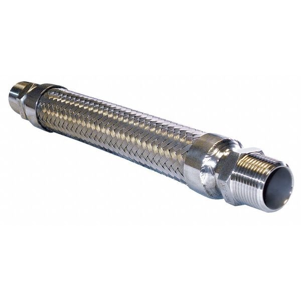

Just a quick question?
Has anyone actually had to use the Northern Tool Warranty?
I paid extra to purchase a 3' flexible compressed air jumper hose. This was a made in the USA product which I like to support when I can.
This hose has catastrophically failed and blew the end off the connection. Let me tell you a 3/4" outlet screaming wide open with 175 psi is LOUD!!
Just glad I was not standing next to it when it let go! I was about 10'-15' away and ran over and shut the breaker off.
Now the problem is Northern Tool says it's over a year old so no coverage? Sorry when anything fails outright from poor manufacturing you need to replace it!!
I will now buy a chinese made flexible stainless steel covered hose for LESS than I paid for the USA made rubber hose. Maybe I am being too picky but take a look at how this failed. A quick inspection and the answer is obvious. The hose was made wrong and the Aluminum crimps were not crimped down hard enough to retain the hose.

I just used a hydraulic hose with the appropriate threads they will hold 1500 to 5000 pounds depending on the hose.
and on the other hose, cut off the furl and possibly cut off the hose end (an inch or so) that was in the ****** put it back on and use a worm drive clamp on it,

Yes I have repaired many leaking hoses by cutting off the end ferrule and using a worm drive clamp replacement. Maybe on this one I will to since the hose is good. However looking at the construction I think I will cut the other end as well and use a worm clamp for added safety!
