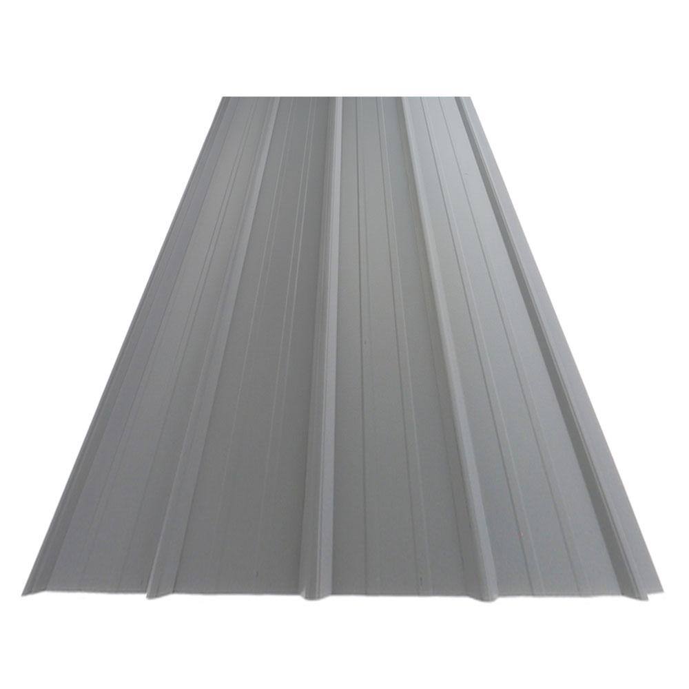

Yes it is fairly low pitch, 2:12, due to a few design constraints.
I assume you're not talking corrugated, but ribbed metal, like this? Hell, it's actually quite a bit cheaper here than OSB or plywood. Here being HD, 29 gauge - maybe that's too thin.
And I was planning on putting all that lumber up. Building the shed out, just without anything but a tarp over the installed joists and perhaps some blocking. But this might be a good alternative. I'll have to check with Mrs aesthetics control officer.

Yes, and it would probably look very nice with a little attention to some good fascia or real clean and neat framing underneath.

I would do metal too. Also at the time of building you should have looked at the available slope and what roofing is rated down to a 2:12 pitch. Standard metal and shingles are only rated down to a 3:12. However this is only a shed so I would just use metal. With shingles you get alot of build up of crud and moss with a low 3:12 slope.
There are cheaper places to buy metal roofing and the proper details than the big box stores. You just need to find them.
