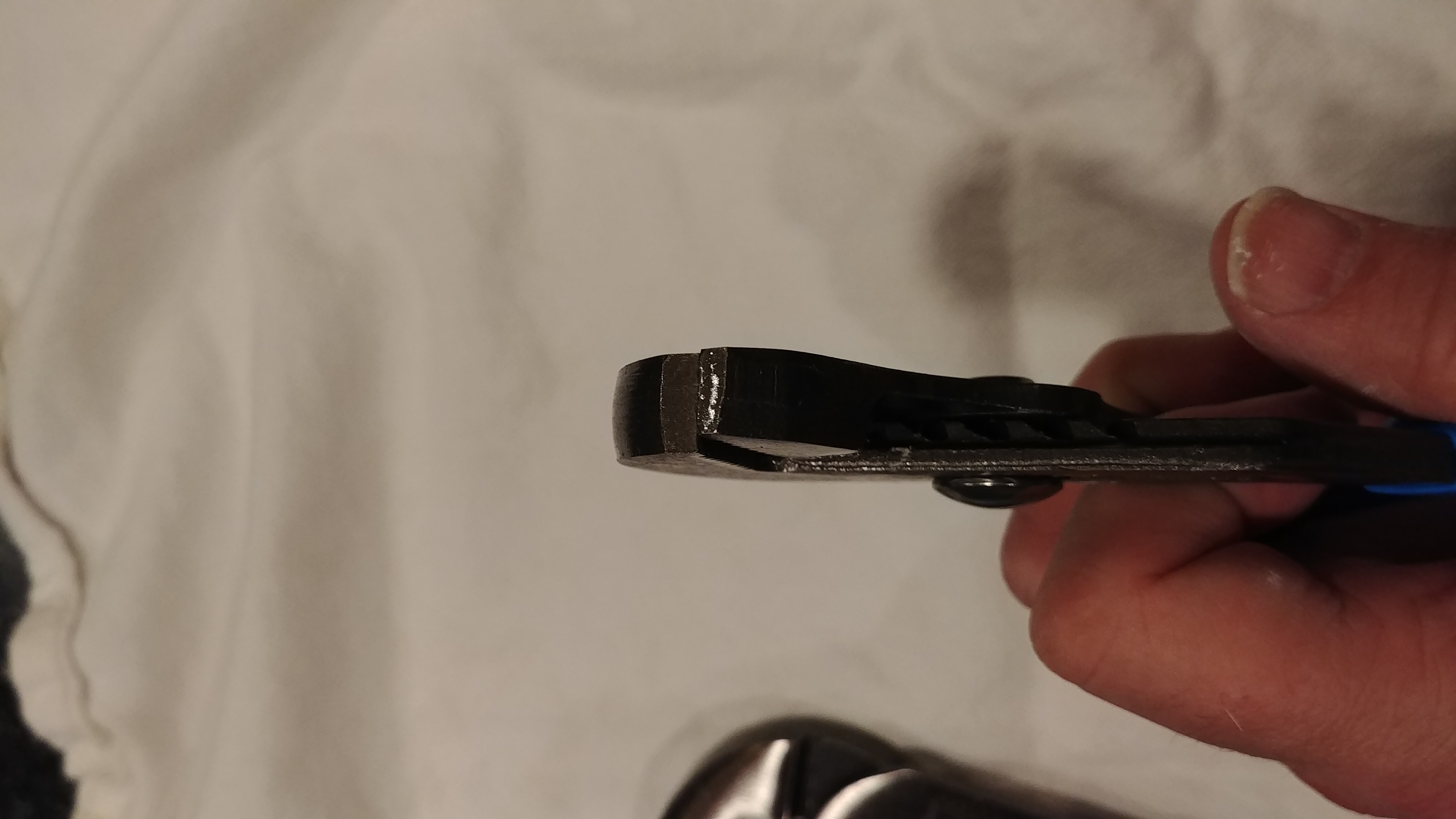

Okay, I'm putting on my flame-retardant asbestos underwear, 'cuz I know this is gonna generate a lot of heat from the Channellocks fans here, but: I bought a 3-pack of Channellocks and I am not super impressed. I don't see why the fandom.
This set comes with 12", 9.5", and 6.5":
Overall they just seem sloppily made.
Every one of them has this mark on it:
I understand that's where they hang them to dip them in rust protection, but if you look at that one, it's starting to rust right at that spot. The coating is just slopped on leaving drips and rings all over the tool. If they have to hang them, why don't they hang them from the handles where it'd be covered by the grips?
The nose of the 12" has an overbite:
I know some people are gonna say these are not precision instruments, but it would have been so easy to have ground them flat so you can grab, say, the protruding end of a nail.

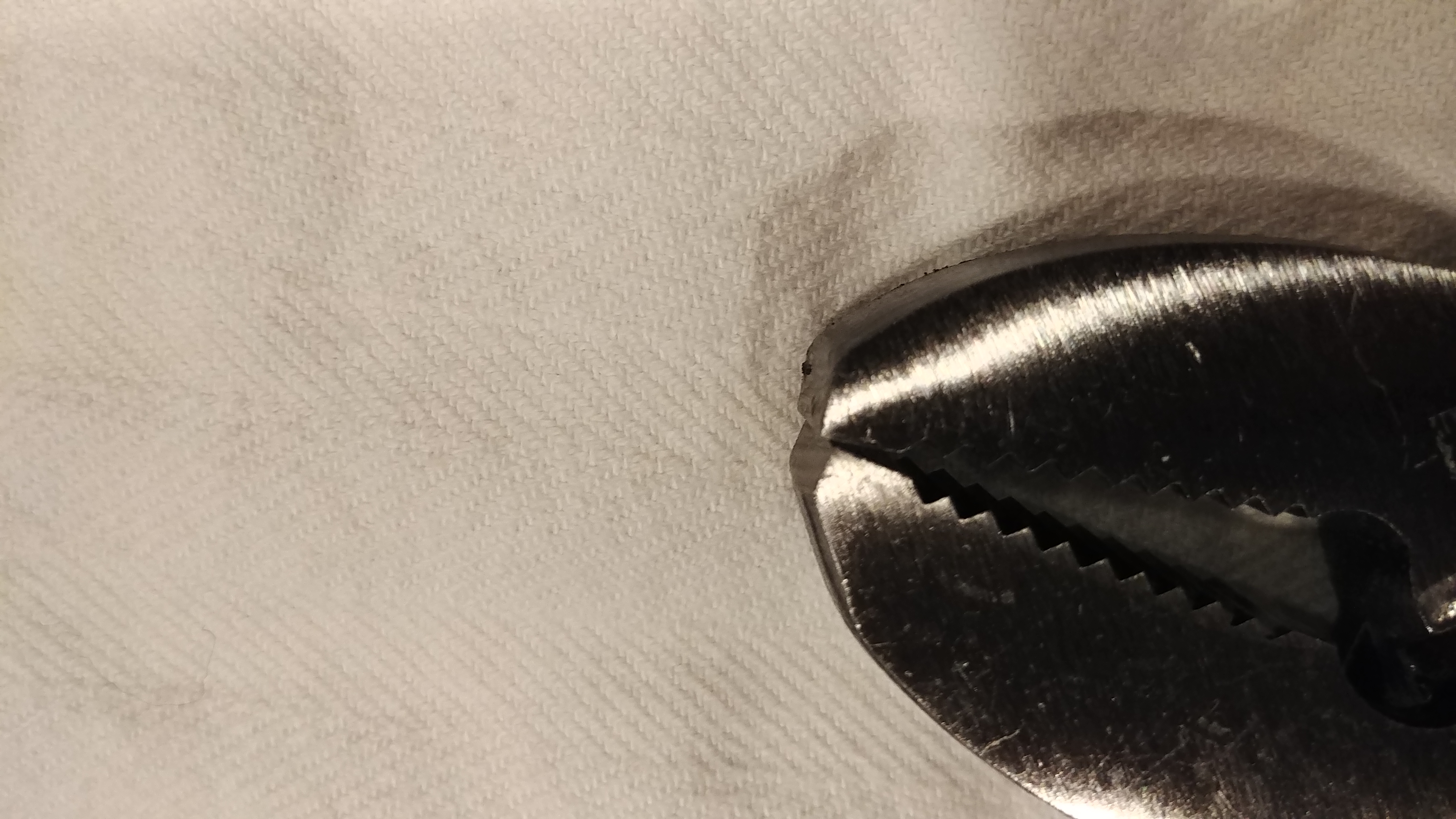

The 9.5" jaws are two different thicknesses altogether:
I wish I'd been able to get good pictures of the hills and valleys in the grinding marks on the big one, but it was too glarey. As to operation, you'll have to take my word that they're sloppy and loose except when they bind.
**** I've got a pair of channel locks and the jaws look exactly like yours do on the 9.5, it's so not even close that I figured it had to have been designed that way :D Either way I think the appeal is cheap, useable, American made tools. My misaligned pliers have been in use for years now without issue. Depending on what you do the issues described don't really affect use much. I've been a plumber and a mechanic, and never once had an issue with channellocks for various tasks in those trades. Everyone's got a pair (Tho now people are moving over to Knipex more and more) I'm not trying to defend them, there's a few people who absolutely hate them and think their quality is going downhill and they may be onto something. That said everyone has a bad batch of tools for one reason or another.

I'm also not sure the 'overbite' of the jaw is something that any manufacturer of tongue and groove pliers can get perfect, although I'll admit I've never looked that closely at any of mine. Depending on what groove you're in, the pivot point is moving, so the jaw alignment in that direction is going to change with each groove. At best I don't think this type of plier was ever designed to use the end to flush grab things - they are for adjusting to different diameters of round (or other shapes I suppose) objects and grabbing them in the jaws.
