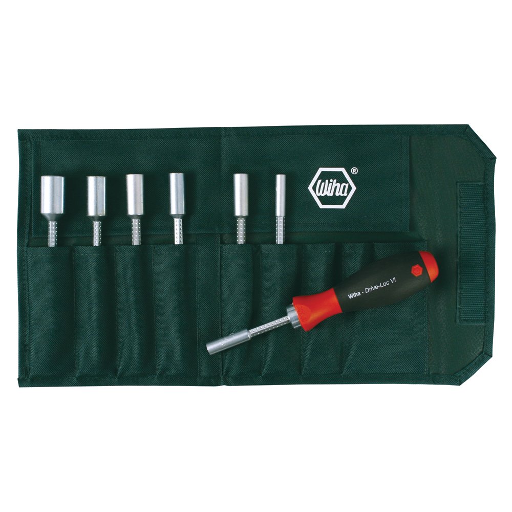

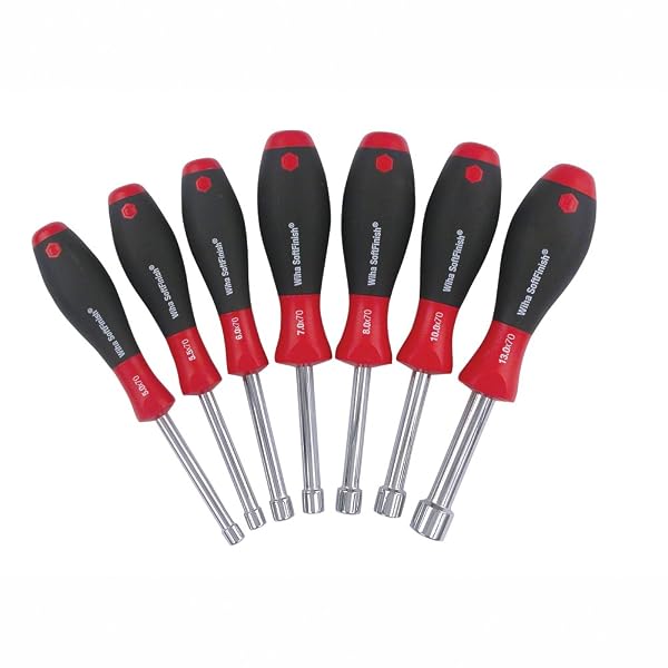

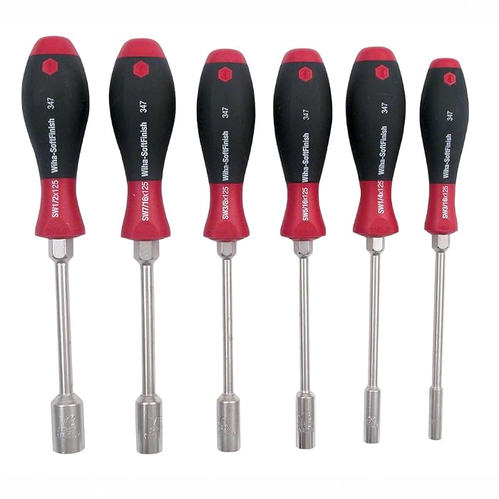

Another vote for the Wiha's...
I have both the hollow shaft and the heavy-duty deep socket, prefer the hollow handle most of the time.
I also use 1/4" deep snap-on sockets and driver extension, frequently but it's nice to have the dedicated nut drivers as well.
Hollow shaft:
Heavy duty deep socket:
