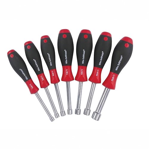

I use my metric Wiha nut drivers all the time...
But I also use my SO 1/4" extension handle and 1/4" deep sockets a bunch as well, usually if something needs more torque than I can get with a screwdriver handle. They don't seem to make those extension handles any more, current versions don't have the 1/4" female on the top so you can plug a ratchet into them... Real shame, one of my favorite tools!
