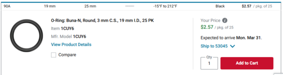

I ended up going with some Buna-N o-rings from Grainger that were 19mm inside diameter and 3mm thick. They seemed to fit in pretty well and stopped about 99% of the leaking. There's still a tiny drip, but that's probably because the inside of the aluminum coupling where the o-ring contacts is corroded to hell. I should be able to squeeze a few more years out of this cart, at least.
Hope this helps some others out!
