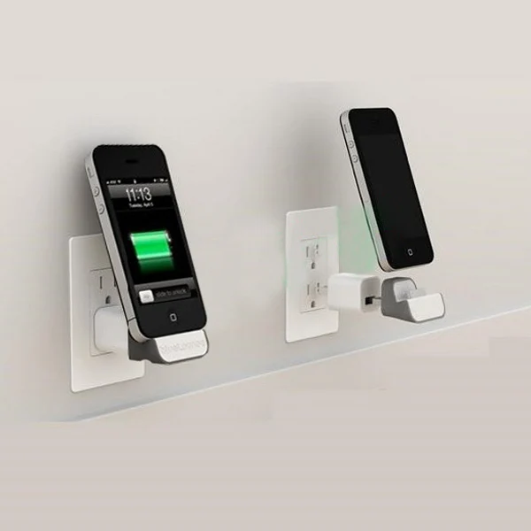

I've lived in that area my whole life, and I grew up thinking EMT was normal. Learned to bend conduit when I was a teenager. Didn't realize it was so unusual until much later.
Another unusual thing about Chicago is that outlets are typically mounted horizontally. Usually it's 4" metal boxes with single-gang mud rings, so it's possible to attach them either way, but everyone does them horizontal. It's a problem for the occasional accessory or appliance that assumes a vertical plug, like this one:
Mini-iDock-Wall-Wireless-Charging-Charger-Stand-Station-Dock-Free-US-EU-Power-Adapter-For-iPhone.jpg_640x640.jpg
